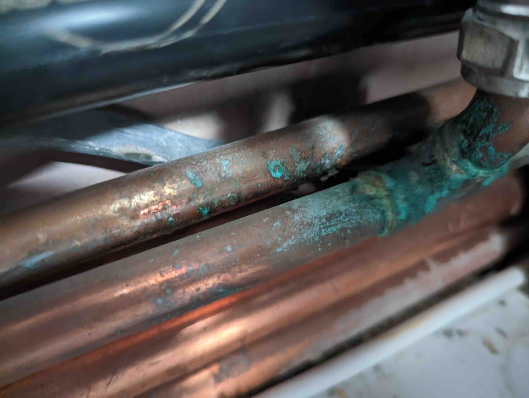

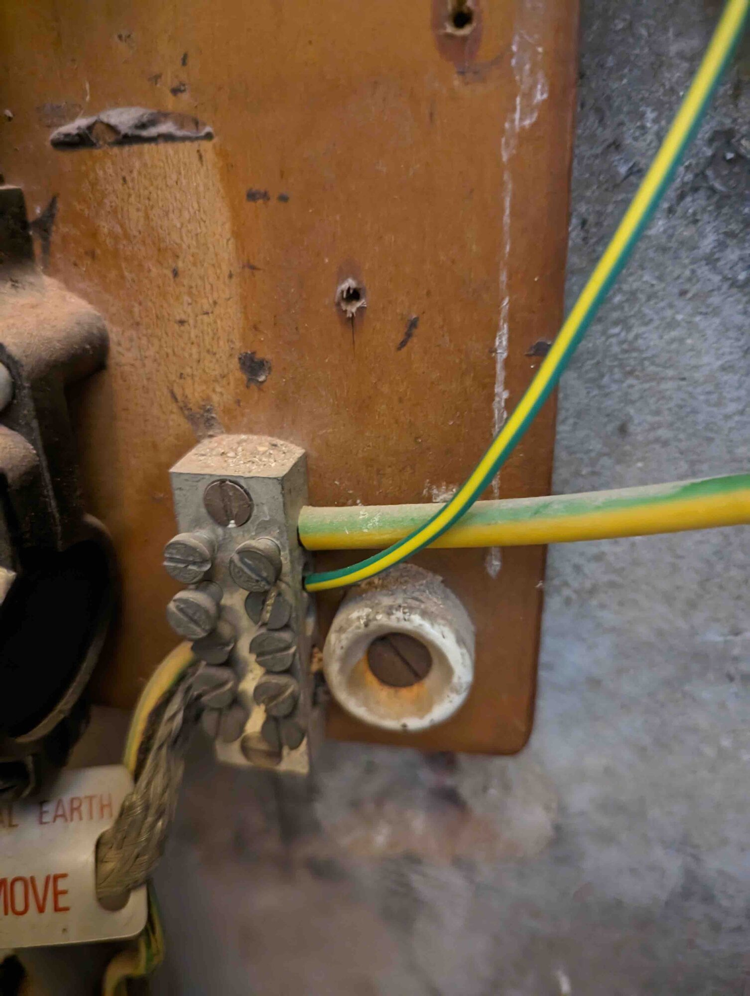

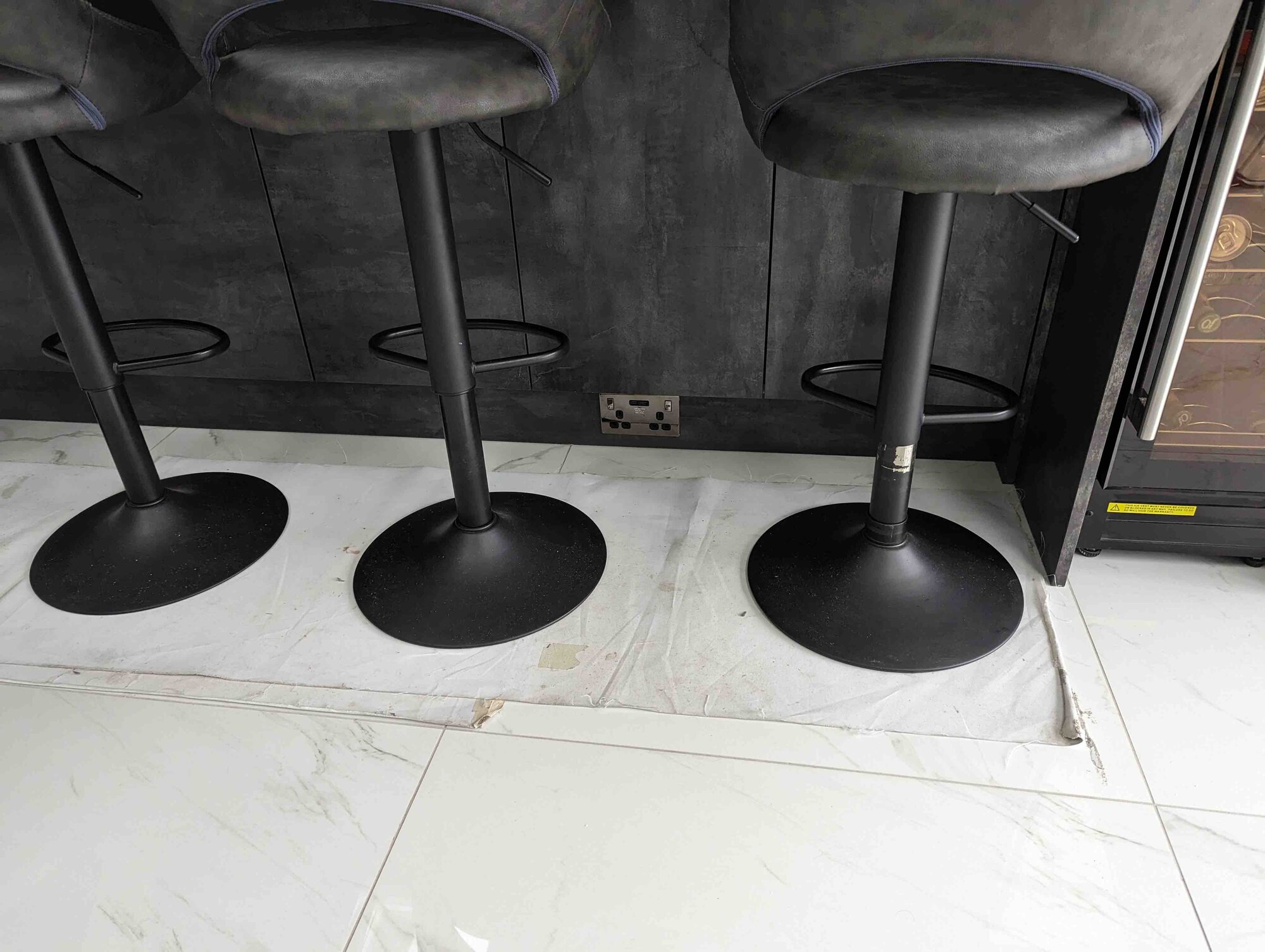

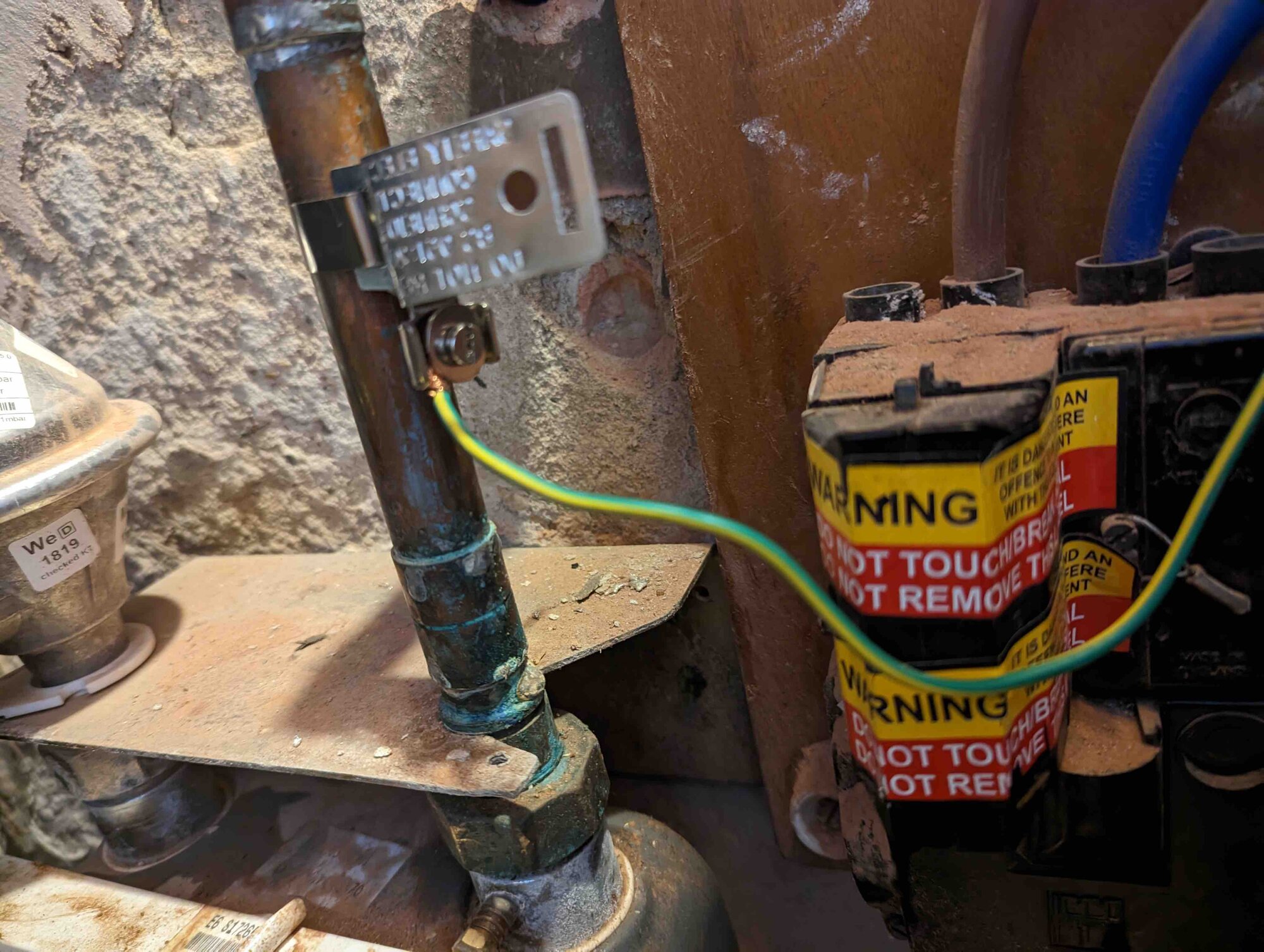

Hi
Did a call out yesterday afternoon. Isolated a section of the downstairs ring circuit in the new extension that had a L-E fault. Bit mysterious however the homeowner then began mentioning rats. Went next door and the neighbour showed us where he had blocked up some rat burrows right beside/underneath the extension. He said he could poke a stick right underneath and feel the buildings insulation?! So anyway the construction looked a bit suspect and it wasn't clear how the rats could of reached the cables from the outside but it seems obvious they did, there could be no other explanation for the faulty cable.
So it could of been straightforward to replace the cable. However the whole electrical installation for the extension was terrible. Not just sloppy but totally amatuer and DIY. Pics below. There was no way I could return the circuit to 32amps which included the kitchen. The thing is the whole thing had been signed off by a NAPIT electrician and accepted by the building control officer. I suggested to the homeowner that they contact NAPIT and for compensation and or correction. Does anyone know how this process works? I would expect a full inspection to take place first before anyone can quote for remedial works. Should they be doing this?
Currently they have a 20amp circuit with some sockets disconnected as there are many 1.5mm radials from the ring from hidden junction boxes. They need to get it fixed quickly. How long do you think this process could take? Any advice?
Thanks
Spynage

The wiring in the pictures is atrocious and needs ripping out and re-wiring Asap,
