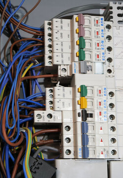

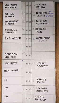

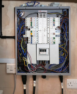

We love pictures to study........
EV Charger is on an NCN132 C32 MCB.
The Powerwall does not have its own trip on the board, the incoming tails are inturrupted on L1, I understand and go to the 'Gateway Control'. Hefty cable from there to battery.
Photos attached as requested - the board is as left by the installing sparks other than 2 changes:-
1) 10mm cable running to garage and W/S where I put in a sub-board with RCD. I was getting nuisance tripping on my lathe and found by changing the 'W/S' RCBO on the main board for an MCB it solved the problem.
2) 3 x sensors added for battery.
Thanks for your persistance
Pete
  • Concern re 3 Phase imbalance Memshield 1 - EletriciansForums.net
  • Concern re 3 Phase imbalance Memshield 2 - EletriciansForums.net
  • Concern re 3 Phase imbalance Memshield 3 - EletriciansForums.net
