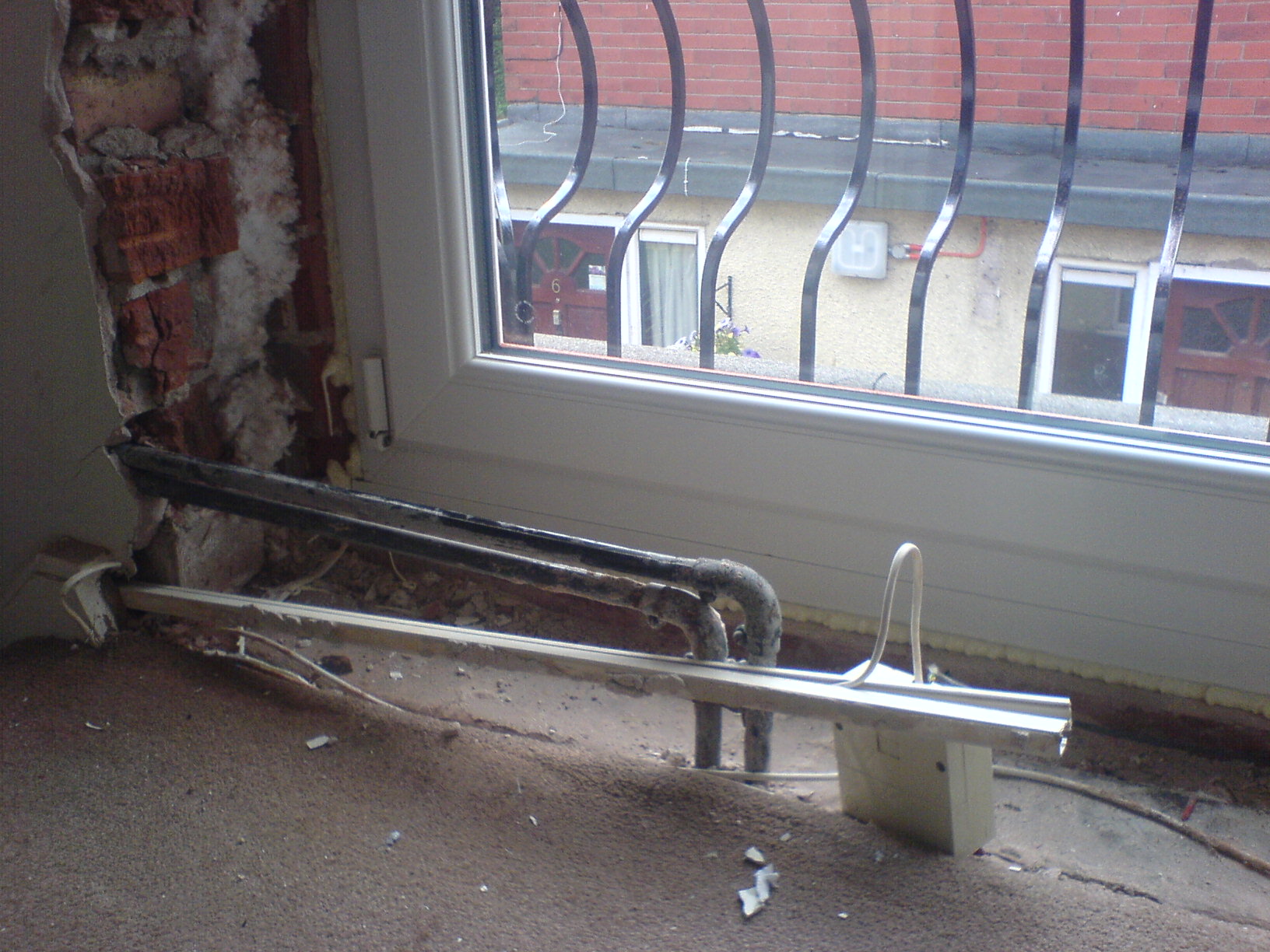

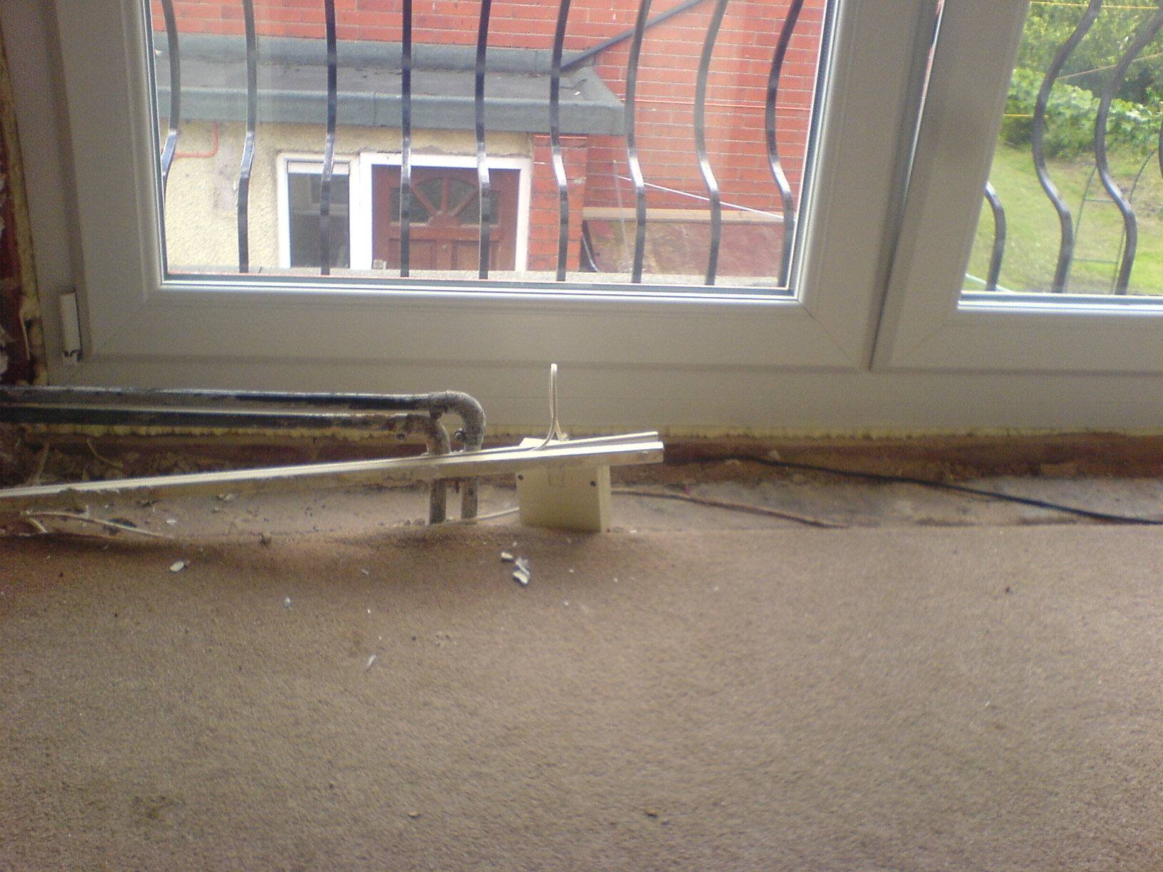

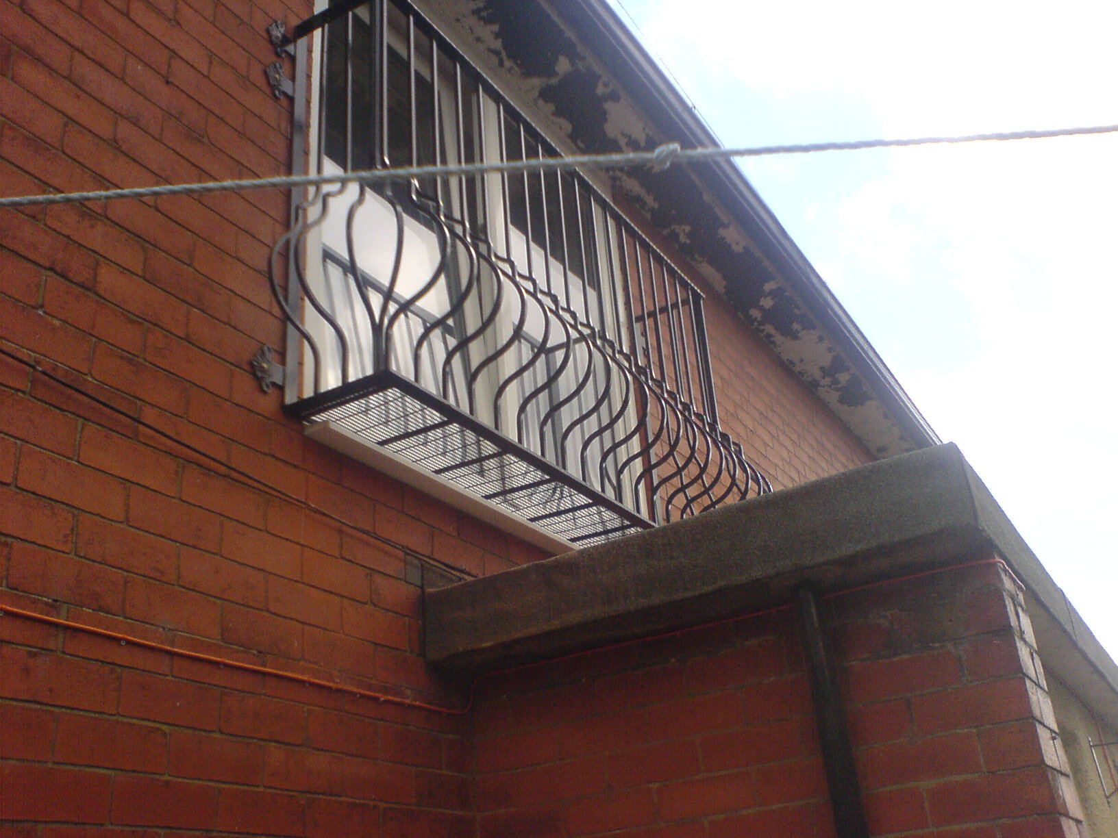

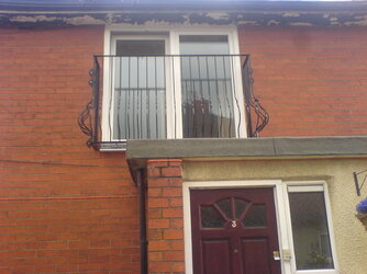

Thinking about conduit in domestic, I found this a while back. It used to be a council flat with concrete floors. It was bought privately and this window/outside shelf arrangement installed. I was asked to sort things out so they could internally open the window properly.....politely declined.

By the way.....in those first two photos you can see some orange pyro. They were new, for security lighting......the reason we were on site in the first place. It was a nice little council job, about 20 floods.
