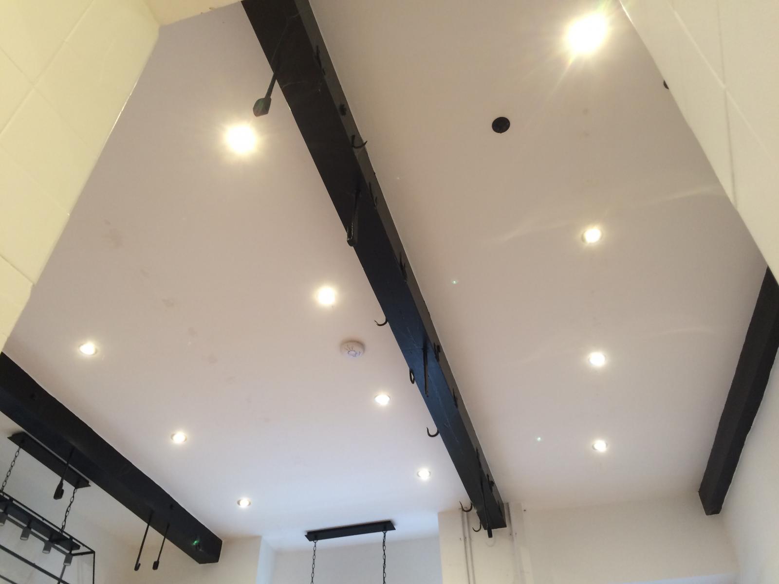

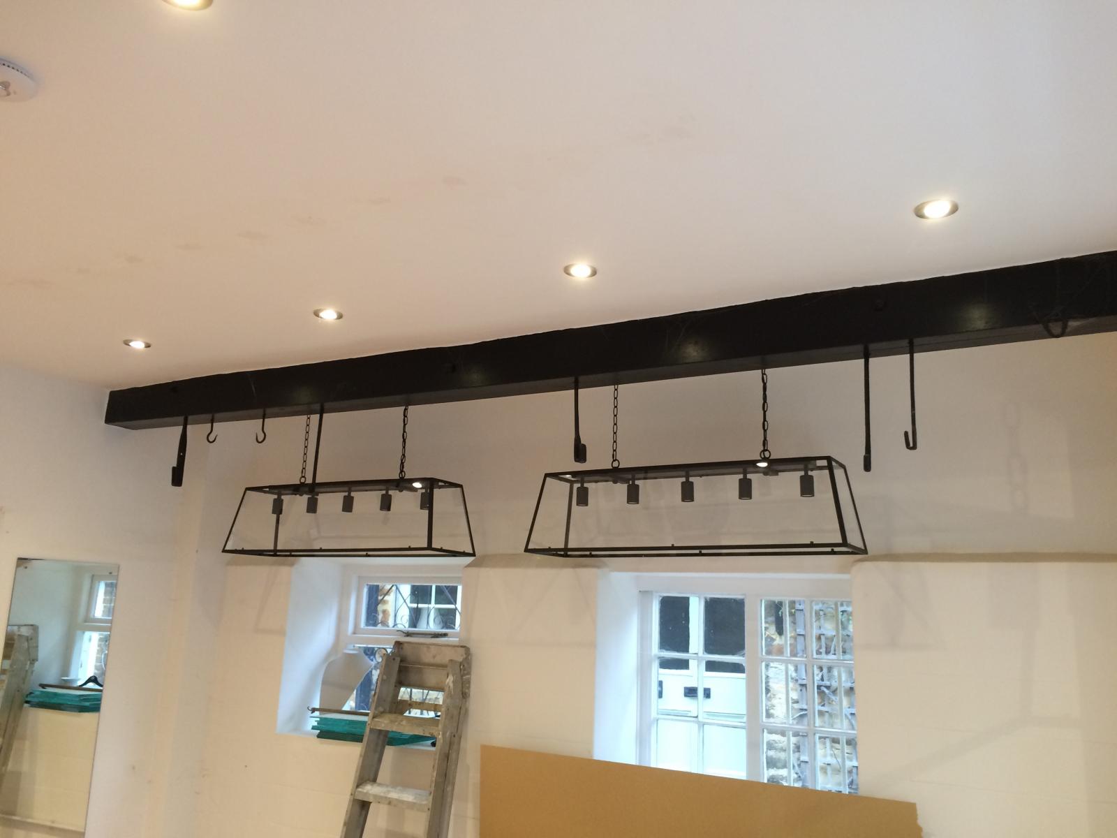

this sodding toilet is a pain in the bum, I had to hang a sodding chandelier in there last week, apparently snobby people who have their nails done etc like to have a nice toilet.

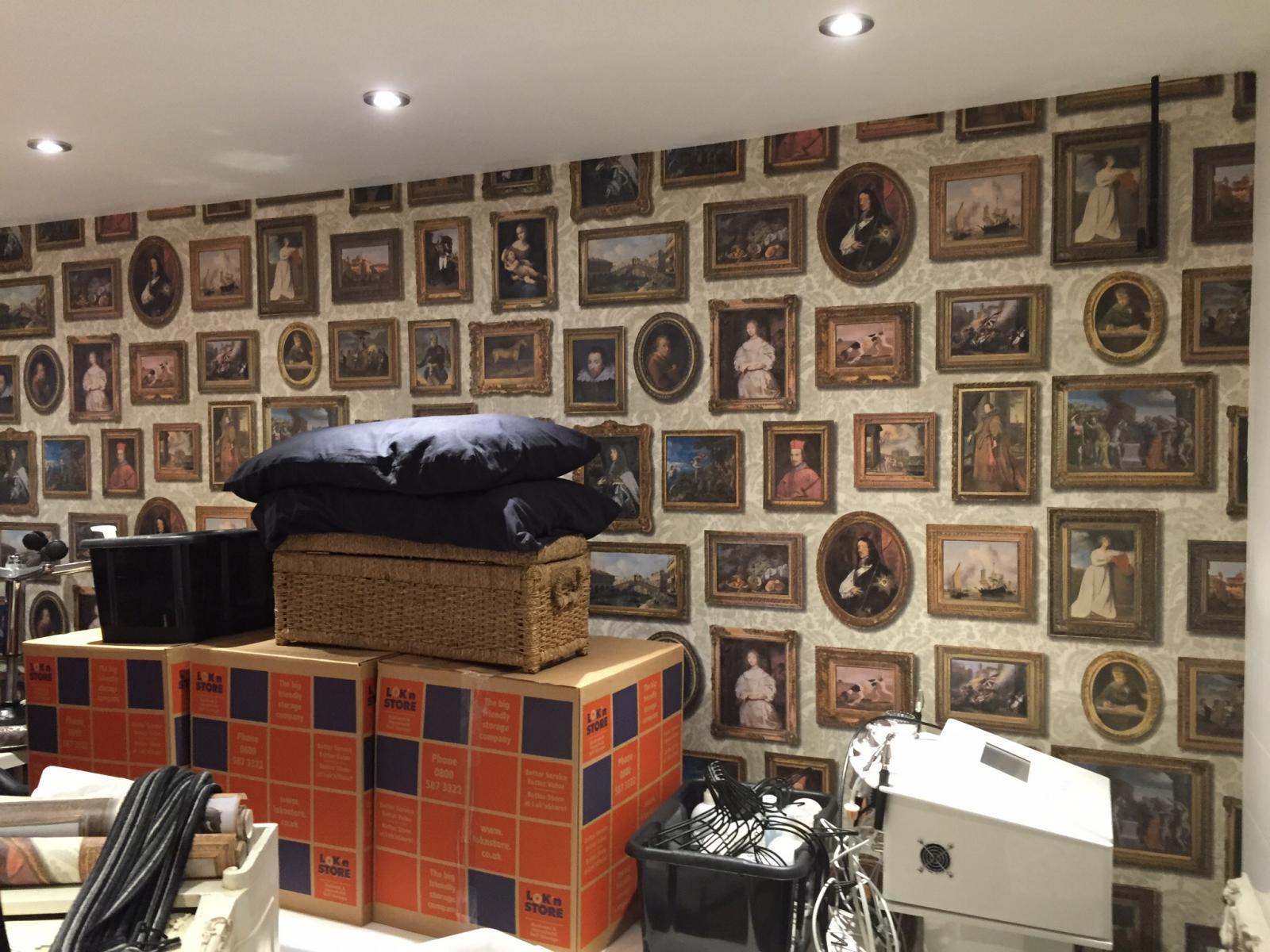

check the wall paper out, this was ÂŁ150 per roll I think they said!
I couldn't care less how much money was wasted on upside down feeding troughs.
I was just curious as to whether they were going to burn out the lamp holders and internal wiring in a matter of weeks or not.
They'd be buggered if the top was closed, the heat from the lamps would knacker them very quickly. It's the same as those glass teardrop shaped lampshades you can get or fire rated downlights with dichroic lamps in.
The combined heat output from 5x 60W lamps is quite considerable!
