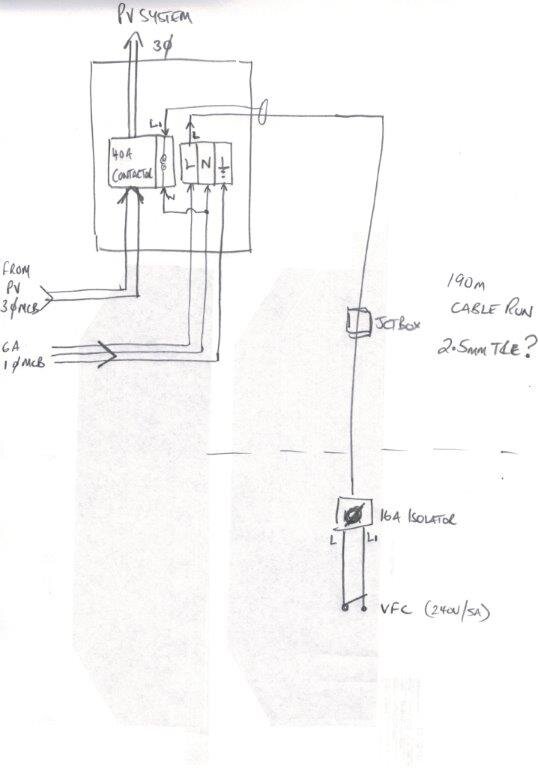

Hi
We have recently installed a PV system that needs to be switched when a generator starts. The generator control panel has a VFC (240V/5A) we can use to signal the contactor. There is a 150m run to the PV supply I need to isolate. I was planning to use a 40A contactor to isolate, however this is where I am a bit sketchy as its a long time since I've done anything like this. I have been told I need to use a relay as the VFC is 5A max. Can someone please help and explain what I need and how to wire this. Thanks.

Ive attached a sketch of what I think is right. My main questions are :
1. Is this ok to wire like this or do I need a relay of sorts for the feed over to the VFC?
2. Will a 2.5 T&E cable be ok for the 190m run?

Use a 24V AC octal base relay and a 15VA 230/24V transformer. Switch the contactor via the relay. I would include a fuse for the transformer.
The relay is usually only about 5VA but the transformer will give a bit of leeway when things get altered (as they invariably do.)
