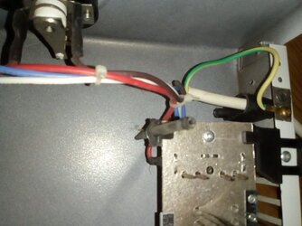

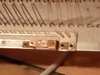

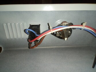

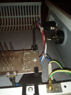

Thank you for the reply and sorry not to reply to yours sooner. I attach some photos, I don't know if you can make anything of the problem from them. I wondered if it could be something to do with a problem with the switches meaning the circuit shorts via the switches in some way and therefore the elements never heat up?

I can't see anything untoward in the photos you've posted.
I'd suggest next step is, obviously with the heater unplugged, to very carefully remove the heater element and inspect the back of it. It looks like it's made of Mica so it will be crumbly and fall apart if you're not careful. There's almost certainly a thermal fuse or two somewhere on the element itself, it could be descrete components or it could be an exposed thermal wire or track somewhere that just melts open circuit.
Once the heater is removed and the wires are disconnected you can do a proper continuity test on both the heaters. Whilst the load is disconnected you can also do a proper continuity test across the contacts of the switches and thermostat.

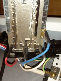

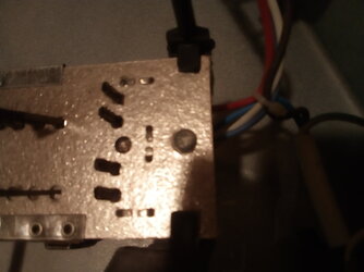

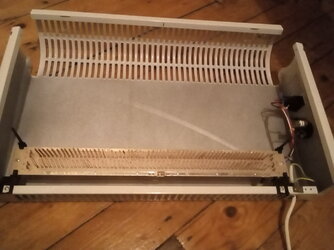

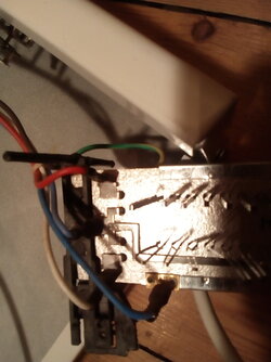

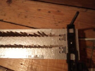

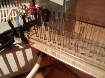

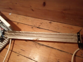

Thank you for the reply. I can't test the continuity again at the moment, I'll have to reborrow a test meter from a friend to do that, but I did previously test it across the elements as far as I could - from the little bits (shown in the last attached photo) that stick up at either end of the element to those on the opposite side and to where the wires come in and it all seemed fine (I also tested across the switches -- though perhaps not the right bit of them as I don't understand the wiring -- and the thermostat). Though I don't actually understand at all how the element circuit is supposed to work -- presumably some of it is sandwiched within the mica?
Anyway I have removed the heater element and attach a few more photos, showing the underneath more clearly. I can't see anything resembling a thermal fuse, just the thermal cut-out halfway along. There are white, blue and red wires going in across one end and another blue wire a bit further along above the white one, going into the start of a metal strip along the edge of the mica halfway along which the thermal cut-out is found.
The fact that there seemed to be continuity in all the individual elements is what made me wonder whether it could somehow be shorting within the switch such that the electricity doesn't flow through the elements? Though I don't see if that can explain why the switch lights don't go on? I guess the thermal cut-out could be flicking as soon as electricity goes through it but would it really do that in a millisecond and wouldn't I hear a little click (which is audible when the cut-out is flicked with a fingernail)?

I'm in rural Mozambique this week and my internet is running at 1990's dial-up speeds so even looking at the pictures takes about 15 minutes.... I'm also using a 20 or maybe 25 year old crt monitor so I'm probably not going to be much help.
I can see the thermal safety cut-out on the back of the element panel which makes sense and nothing is jumping out as a problem. If the two contacts are tight together under spring tension then that's unlikely to be the issue.
You're definately going to need a tester with a resistance mode to fault find this thing any further.
