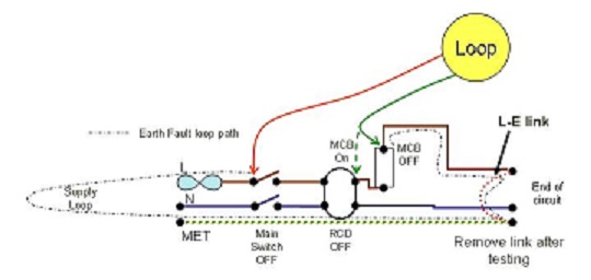

use this method.it bypasses the RCD and/or the MCB. remember to remiove the L-E short before re-energising. set mft to hi-current, not no trip.

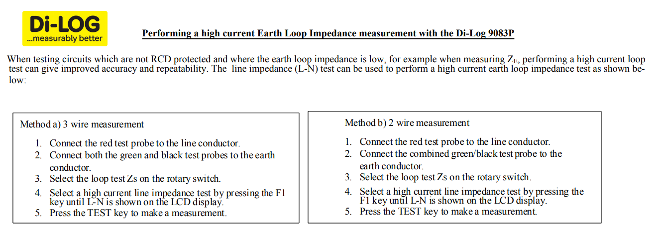

should do.but never heard of a mft without hi-current Zs facility.how do you measure Ze?

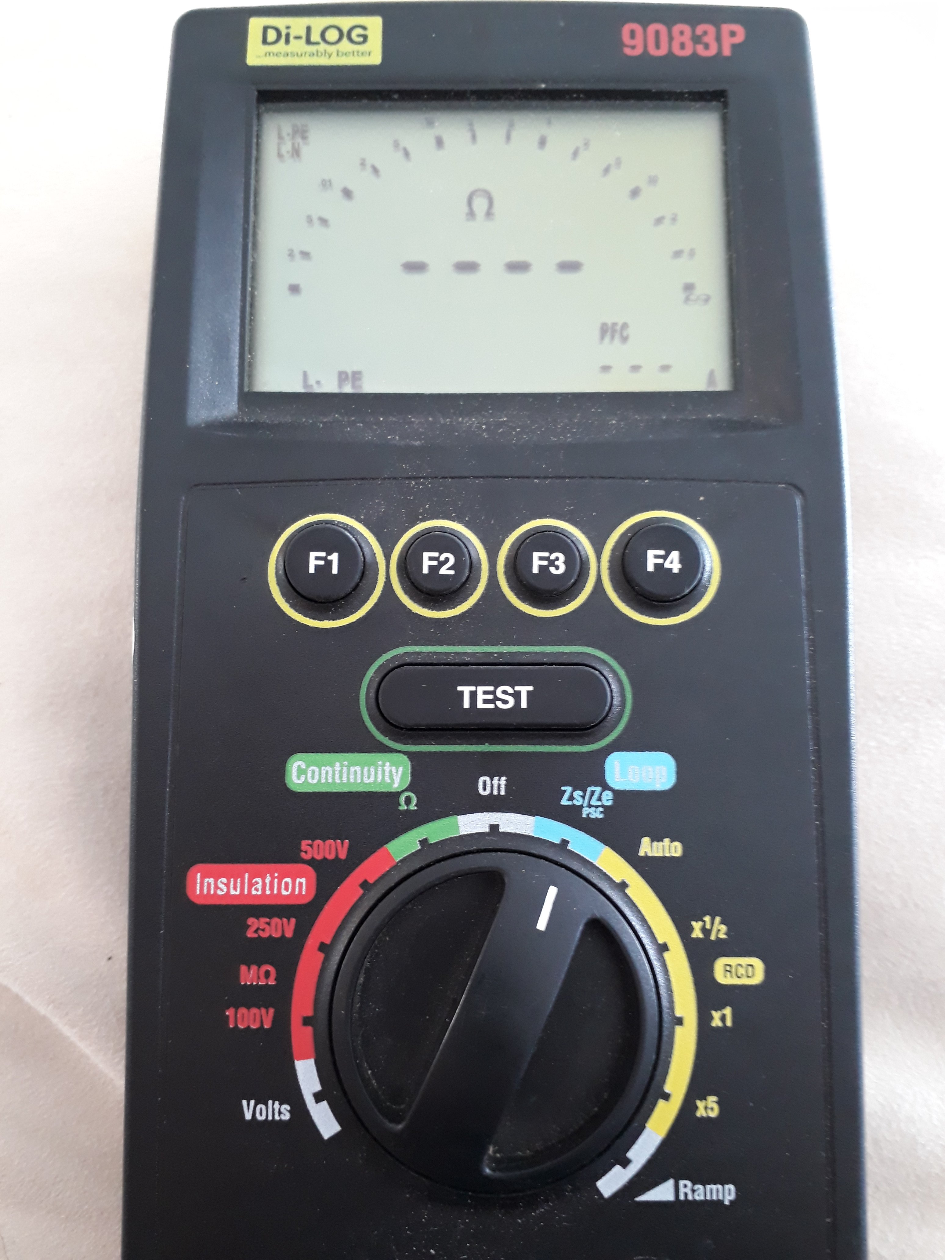

Telectrix- MFT is a Di-log 9083P and definately doesn't have a high current option. All loop tests are carried out at 15mA. Photo is attached showing the dial and screen when in loop setting.

I am convinced it's the RCD causing the higher readings so wanted to check ZS on incoming and outgoing terminals and compare the 2 but as it's Starbreaker with the internal busbar, there are no line terminals to test on. Is there any way I can test this ...
Test at the main switch (as already suggested) and then access the outgoing line by prodding the conductor of the insulated bussbar. Pull the MCB out to do it if necessary.
