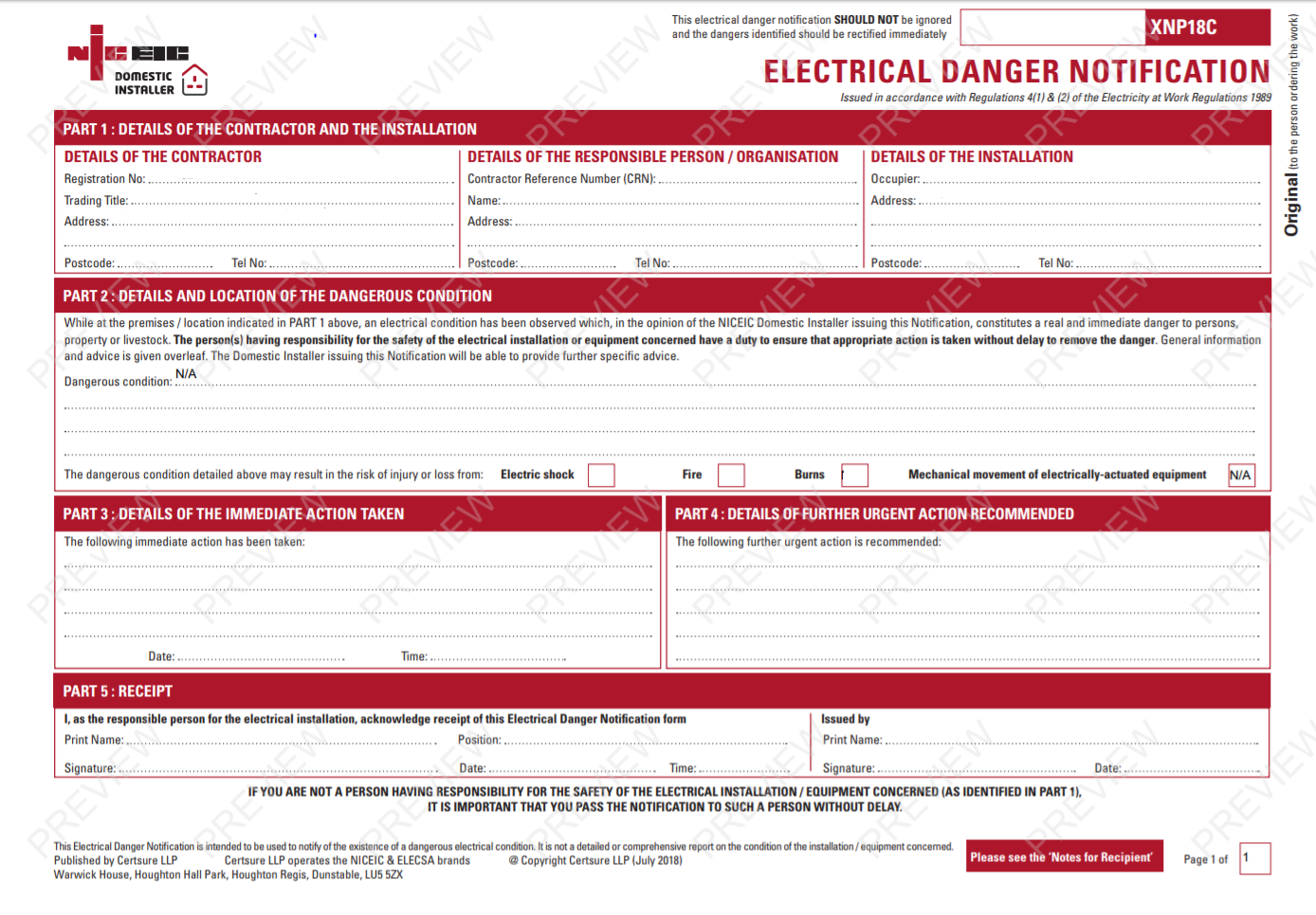

Reading another thread a moment ago about EICRS and lack of CPC and whether you should disconnect the circuit.
How many people actually issue dangerous installation certificates? an example of the 18th ed from NICEIC is below.
I have issued a couple where i have attended and found things dangerous, ie shower with no CPC or bodged circuits.
Customer doesn't want to pay for repairs as in there mind it still works so why do anything about it!
I know as soon as I was out the door the customer would turn it back on. So issue one to cover myself. This day and age I think it pays to cover your backside and it could be argued that if carrying out an EICR then it might pay to leave one of these with the person in the property if its dangerous and give copies to others or fix to consumer unit aswell.
Thoughts?
I think the Form is excellent however the as yet legally untested element is what authority/responsibility the Inspector has to actually disconnect the clients equipment.
Legally the Duty Holder is the Occupant or Landlord and that is how the guidance is written. An electrical inspector is acting in an advisory capacity only, again something I believe is made clear in BS7161.
My reading and understanding is that the only requirement on the Inspector is to bring the matter to the attention of the Duty Holder. To disconnect could well be judged as criminal damage and you could be disconnecting equipment that is necessary for someone's health or safety, such as medical equipment.
The only person with a legal right to disconnect is the DNO and I would suggest that depending upon the response of the Duty Holder that the Inspector if he feels there is imminent danger should call on the DNO and ask them to inspect and decide whether or not they disconnect the whole supply.

Yes I have issued quite a few danger notices. Some as arse covers until I carried out agreed work, some as genuine warnings to stubborn customers.
Some for lack of installation earth. I was just digging for work though as the last 5 decades had been safe enough according to the householders that never called me back.

I do find though that with the notices customer thinks you are trying to fleece them out of money regardless. It is a way of encouraging the customer to get work done.
They cant see or dont understand the issue. It either works or it doesnt. No in between for a lot of them.
The age we live in though means you got to cover yourself.
