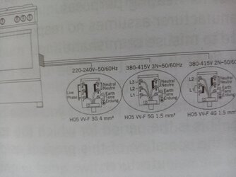

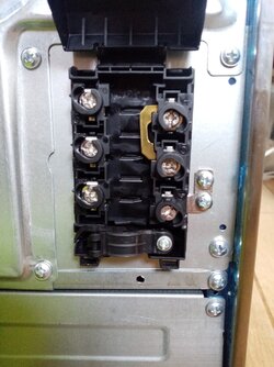

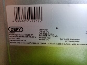

I am trying to figure out if my defy dgs906 gas/electric oven is single or 3 phase. The manual says it can be either or but the L1, L2 and L3 are not bridged so I assume its 3 phase.
I am not doing the wiring but need to pull the correct cable before the electrician comes to install as I live on a farm and its costing me per hour that he comes out to install. (I have messaged him asking for advice but he hasnt replied and is coming tomorrow morning).
Please see attached pics, any advice would be appreciated.
Thanks.

According to the wiring diagram, it can be either, you just add the approriate link according to which supply you have. If it is new, perhaps there is a link included somewhere? If not new, then either the oven was used 3-phase or the link has got lost.
Thank you.
It is a new stove and there is no extra link supplied. I have 3 phase so can connect it 3 phase but would this not be a problem if it is meant to be single phase? (220v vs 380v)
Wonder why the instructions specify 4mm2 for single phase, which you will struggle to connect in that box. It's only 3.6kW, which is well within the capacity of 2.5mm2.
