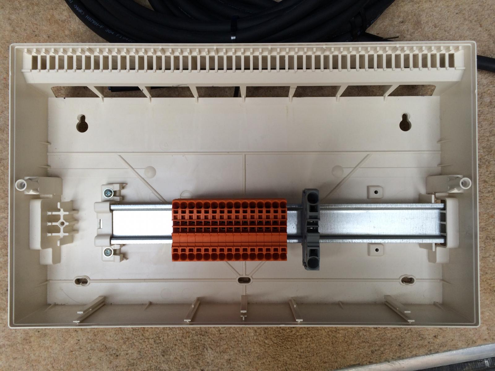

I have solved my problem, im going to use a spare MK consumer unit chasis, the front, ive got some clear perspex ill glue to the read of the hole instead of blanks, seems to fit, once all the connectors are on and the end stops, it will look fine, its going to me a matching MK consumer unit fitted below anyway, so it will look ok. Ill peel the stickers off etc and clean it up, I feel there's probably just enough room to get the conductors in ok, ill try it later.

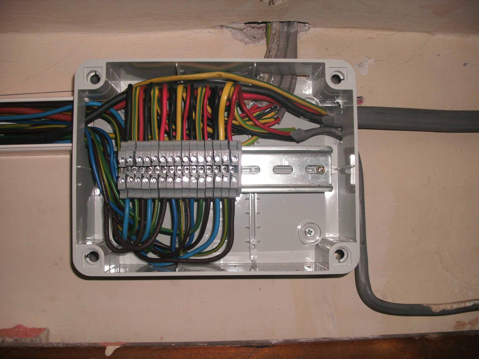

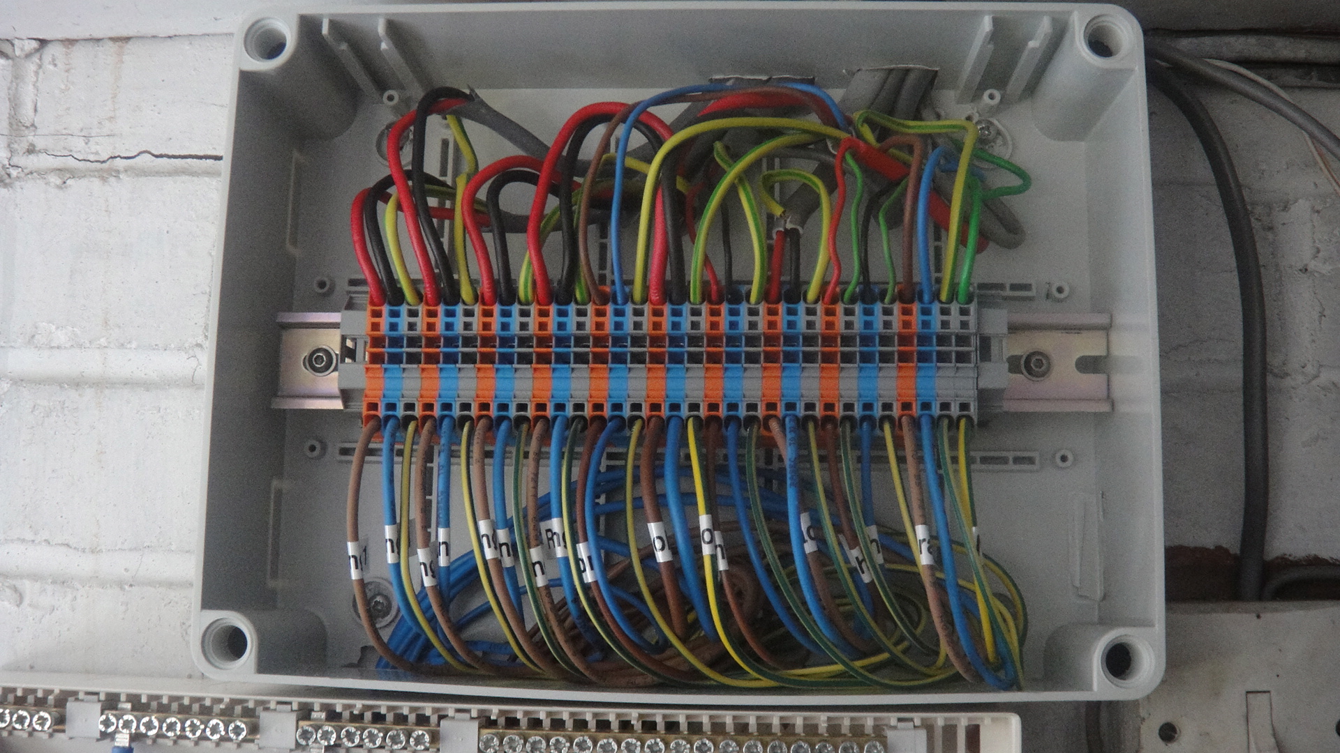

here's one i made earlier.the cpc of the 10mm was re-dressed after the pic.
Here's one i did before too, just trying to save on costs as doing the whole job for £300 inc new board for 10 circuits. Just means I make another £30 odd pound using this old ox, well its new, just a spare empty one.
Keep the empty CU for another job and get yourself a plastic adaptable box. You can buy them with a precut bit of din rail pretty cheaply.
Using the CU enclosure as a joint box is going to look like a bit of a bodge, even if it is compliant.

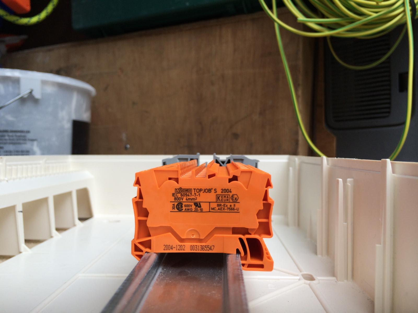

OK check this out... all finished. Do you still think it will look a bodge? I don't, personally I think it will look good, with that at the top, and a matching one 3ft lower with a bit of trunking between. it cleaned up too. Nice! Comments appreciated.

Yes, I would still think it was a bit suspect if I encountered it in an installation.
It looks like a DIY effort at achieving something which could have been simpler.
Does the cost of the MK board, the Perspex and your time to put it together equal less than a plastic dappy box with din rail?

i don't think it looks messy, or DIYish particularly, it shuts with a matching lid so it all looks like an enclosure .

I kind of get the idea of the CU - have 2 CUs next to each other instead of a CU and an adaptable box, but a CU is meant primarily for safety isolation devices, not exclusively for wagos with a bit of perspex over the front.
I agree with Dave - I reckon an adaptable box would be cheaper, possibly better suited, and even look more professional because it wouldn't look like something it isn't. If you're going to stick with the CU, at least take the ident stickers off.
