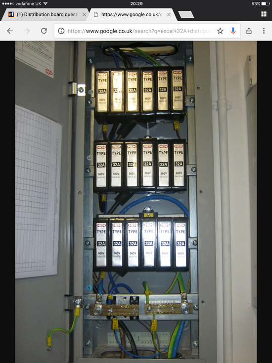

Hi
I've been looking at a drawing of an installation. It says it's a 4 way 32A HRC fuse distribution board. Way one is a three phase load and has 40A fuses on each of the phases. The second way has 3 single phase circuits fused at 16A Each, the others are spare. Is it me missing something or can this be done at way 1?
Thanks
not sure what you are asking.
you seem to have a 4 way 3 phase board.
1st 3 phase way is used. 2nd way is 3 x single phase loads. 3rd and 4th way are spare so can be used for additional circuits.
what's the rating of the main switch in the board?
You will get a 40A to fit them Dave, tested an Exel board a few weeks back that had 40s in 32A holders.
Got a little more info and believe this is the whole picture. The 200A isol mention above is fed from a 63A fuse switch from a main switchboard.
Thanks
