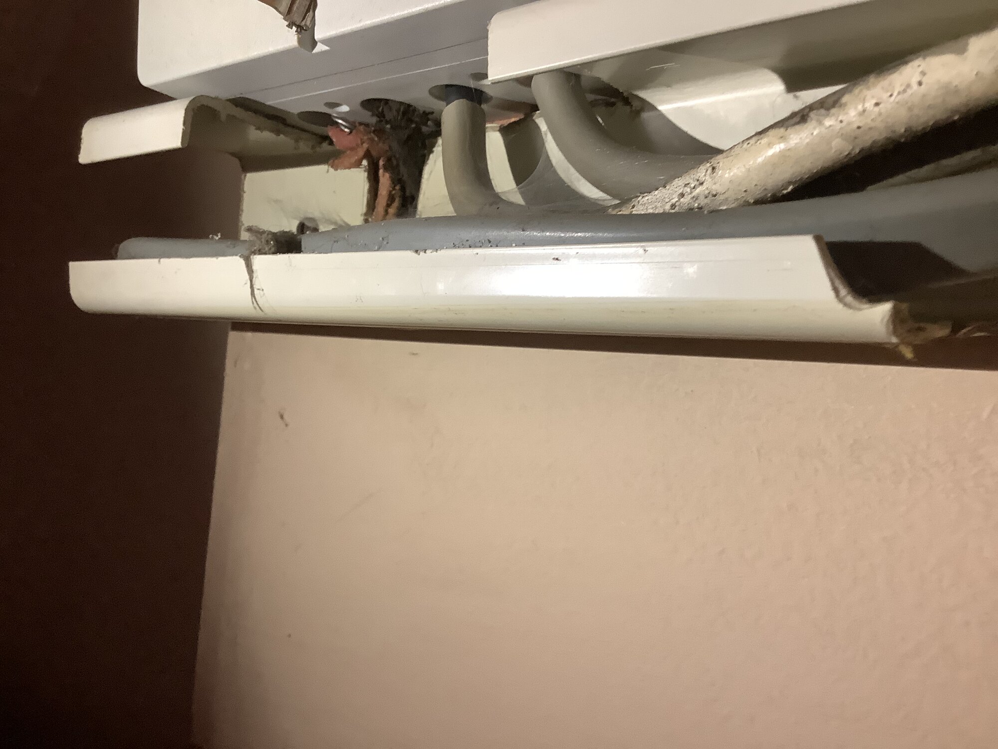

I had a client who had a poor lateral supply and called out the DNO in 2009, SP Energy Networks attended and marked it as an urgent upgrade.
She then called me about more work in February this year and told SP EN had not fixed the problem so she called again, someone looked and said the job would be booked in
They had a poor VIR lateral supply and high Ze reading.
Are DNO's lazy in their efforts ?

Most of the problems I have reported have been fixed on the day and the ones that haven't have been sorted within a few weeks, the only one that dragged on was a service head replacement on a looped supply that took about 9 months partly due to the neighbour being elderly and infirm and partly down SPEN insisting we arranged a date with the neighbour for the work to be carried out I pointed out that I didn't have access to their engineering diary which would make it rather difficult to arrange a mutually convienent date
They came out and looked last Wednesday to run the laterals to next door and decided it was awkward to do this, the subcontractor suggested it was better to run a new cable from the street
I was then called back and told client refused trunking and job was posponed to do a dig - and the dig was planned maintenance
I called back (on conference call with the client) and raised concerns.
Someone called me back on Thursday afternoon and let me know they now planned to do the dig on Friday morning
The job was done last Friday - after a lot of running around.
Client is releived and happy
