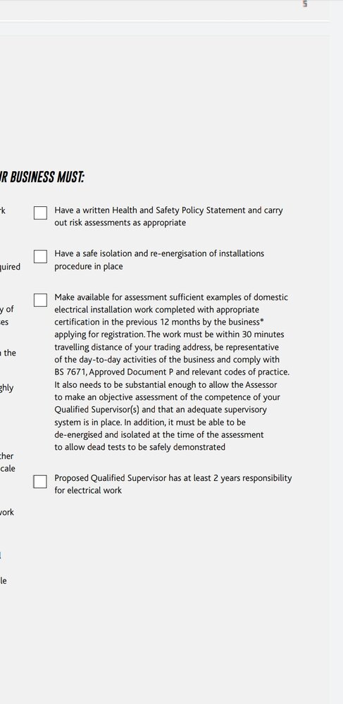

I'm looking to start up my own business as a Domestic Installer, however I'm confused as to whether I need to be a member of a CPS scheme or not.
I have a lvl 3 inspection and testing C&G and completed an installer course and introduction to 3 phase.
I have c&g 18th ed regs.
To become part of a CPS scheme (Part P registered) every company says I need two years experience.
I have experience in small electrical jobs (eg changing of fixtures), but not two years worth of domestic installing as I'm only just qualified and not registered.
Can I carry out domestic electrical work as long as I notify the LABC? This is the only way I can see to build up 2 years experience. I read somewhere that this would incur a great cost and elsewhere that it was illegal for me to carry out work without being in a CPS.
This is so confusing and I cannot find a specific answer to my question. For a industry that is desperate for more qualified technicians you would think that they would make it clear and simple to go from getting qualified to actual work, but that doesn't seem to be the case.
Please can someone give me a straight answer?!

I think I've just found it in their requirements too (only took 4 hours!). New applicants just need to show competence in the work your likely to carry out, no mention of the experience that's in the main scheme requirements.
Phew! Yeah makes sense they'd be happy to take our cash! I've got a DB change and some alterations to do so I can use that hopefully.

Just took on someone like you with a similar background. To be frank I don't think you should go it alone at the moment. You do need to get work with an experienced electrician and build up to it. Yes you could go out and do minor works without scheme membership. Insurance might be quite expensive though. You can ask the local building control how they would view your submitting certs for more major work. But judging by the competency of the person I just took on I would say that you need someone to hone your skills and safe working practices. As to periodic inspection, I am mystified how you can do that! It at least was a requirement to have two years experience to even do the course.

The various Schemes will tell you what quals and work examples they want to see. I don't think they have any qualms about your experience level, but you should consider that yourself, bearing in mind you will be working in peoples homes.

Where has this 'two years experience' requirement been quantified? Might be a good requirement, but never seen it stated IME
This is something I've also been looking at as I've planned to take a similar route. The info they send out states
Proposed Qualified Supewisor has at least 2 years responsibility
for electrical work. But doesn't say it has to be notifiable work. So could you carry out non notifiable work and for any jobs that required signing off sub in a registered sparky to work with you to supervise and sign off for an agreed fee? Or look to sub out to them. You may only need a couple of jobs as evidence for registration towards the end of your two years. That way your still building your own business rather then just working for someone else.
