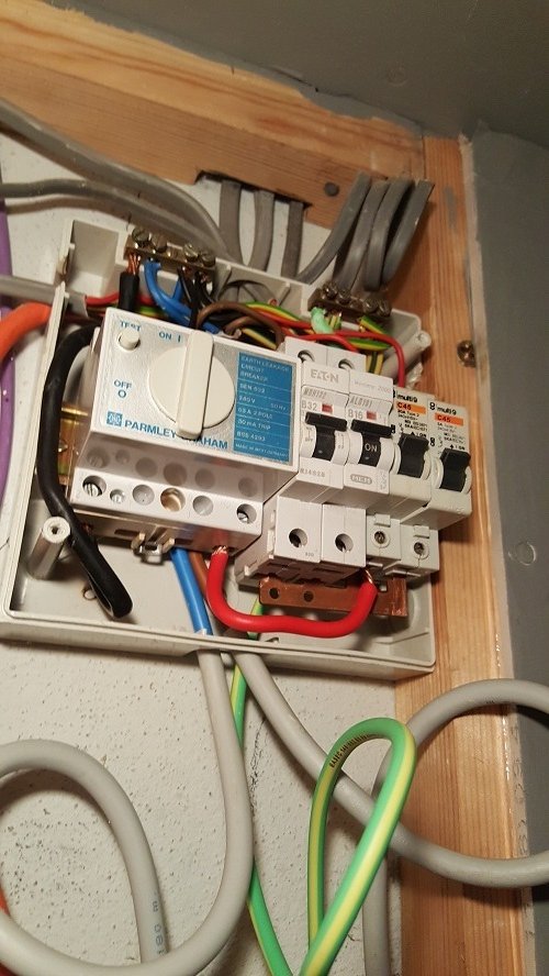

prepared to be shot down here but I've recommended that this get's changed :)
Deceased Hubby did it apparently. Had a run of those recently. Probably
same bloke:)
Amongst other things, the C45's - 1 did the lights (4 x pendants), 1 did a twin socket for the Broadband router.
Anyway it's gone now, nice new shiny Wylex fitted.

A lash up, in my opinion.
C45 is the model number of those MCBs, not the rating, they were the predecessor to the current C60 and C120 range.
It’s not clear in the picture but the rating of one of them appears to be 6A and the other something higher.
looks to me like an adaptable din rail box, bits stuck in DIY.
