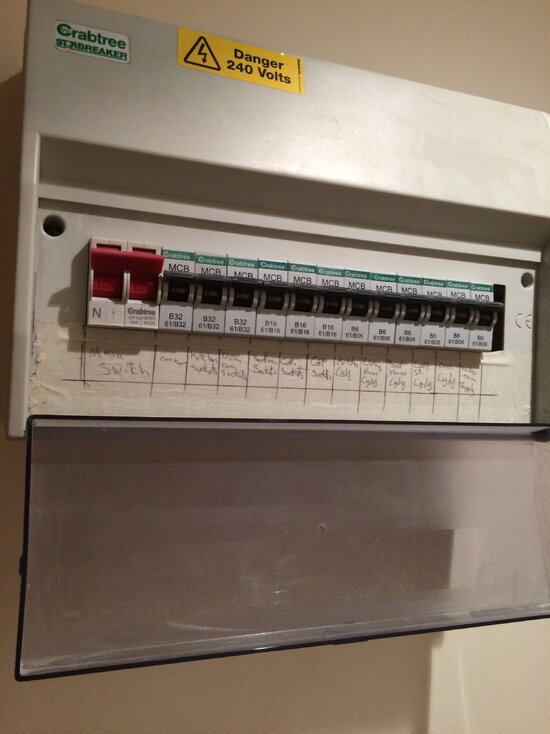

Vortigern do I just flick down the switch for 'kitchen sockets' on the downstairs fuse box then?
Hi yes just pull the switch down and the circuit is isolated. It is not properly labelled you should have a label that indicates the on/off position. But anyway down is off up is on
Just as a bit of advice, don't be alarmed if any of the electricians turning up advise a fuse board upgrade. They aren't fishing for work, it needs one going by the pic :)

I would suggest turning off the 2nd breaker (marked kitchen sockets) till the socket issue has been looked at. You can plug your freezer into one of your many extension leads ;)
