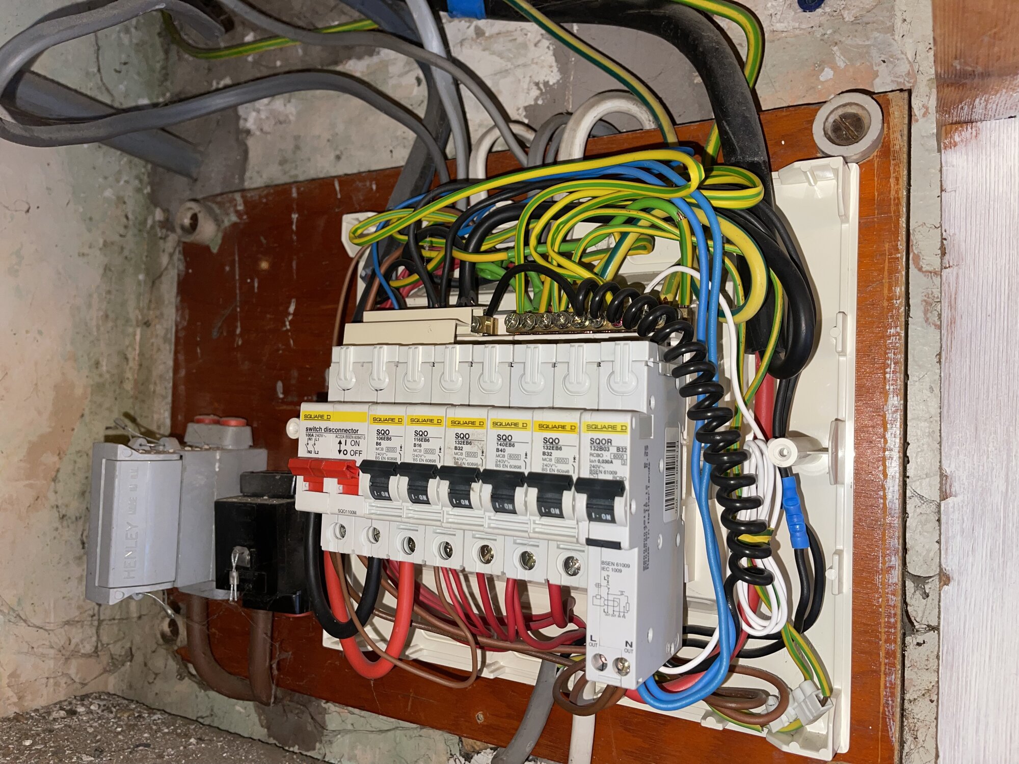

Every single floor installed with wagos without any form of enclosure. Just shoved into the ceiling. First time working in an commercial job site, alarmed at the practices. Not the fault of workmanship but the owner of the electrical company refusing to spend money on key things... even can't be bothered to buy brown sleaving for sw identification. Clearly some of the electricians failing to check connections if connections are tight and then powering sub mains board. This is how fires start.

That last photo is a looped neutral, not a switchwire without brown sleeving. Or were you showing us a loose connection?
The cpc's should have been connected to the metal backbox. Why waste money on a bit of choc block connector when the box has one already there.
Showing loose connection. Board was live and signed off
