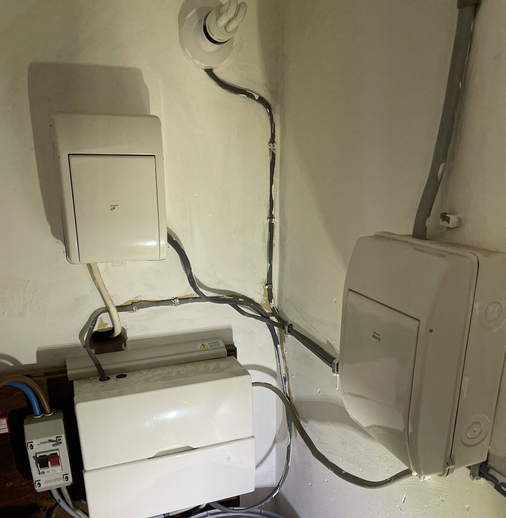

Was At a property to do EICR looking to rent out for first time and, certainly in my top 10 shake of the heads category.. will put all pics on a slide for 2391 training - spot the mistakes..
I looked at consumer unit... owner had issue, and got someone in via insurance, recommended an 'electrician' to change the board, same guy also apparently was a kitchen fitter.. that's another story (yeah removed cooker socket left cable connected , hidden sockets no spur switches etc...)
Anyway was a BG split RCD with 6 breakers - only 4 used (4 light circuits in one breaker).
Also two separate 5 way RCD BG boxes for 2 showers, 6mm (see pic few broken strand so nearer 4mm) feed to these direct via the isolator switch* straight from the national grid see pic - - with 50Amp MCB's using 10mm to the showers. Found despite connected only one electric shower fitted, other cable buried in wall still live.. - so disconnected unused and will move / upgrade other to 10mm.
Apparently also told customer that was biggest board - honestly I would've fitted 15 way RCBO in the space and left room for future eg EV etc..
Then neutral disconnected this turned out to be ring main for. upstairs and should be on LHS so only 1 Neutral connected customer told me there had been odd tripping.
And to top it off - no protection used at any entries, meter tails thru separate entries..
Will stick up the fixed photos.
