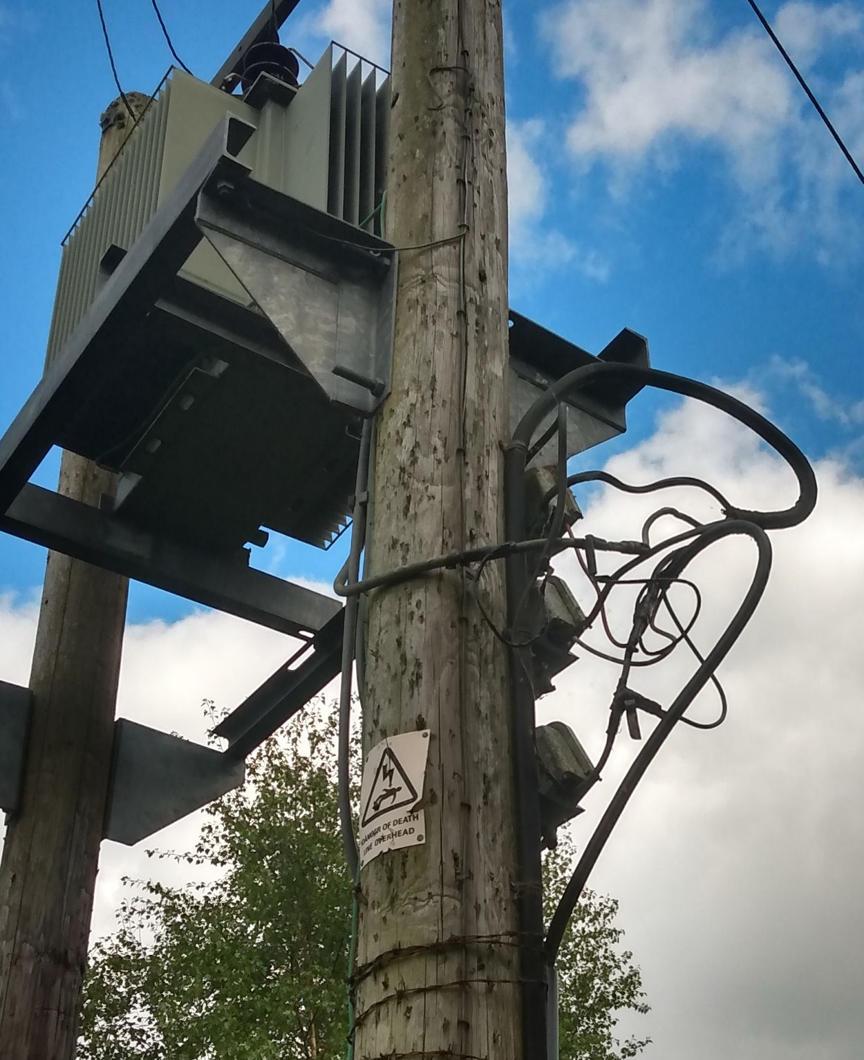

And going for a walk with a friend up a local hill, some rough as badger's work on adding more LV cables to a feed to one of the antenna mast's equipment:View attachment 98071

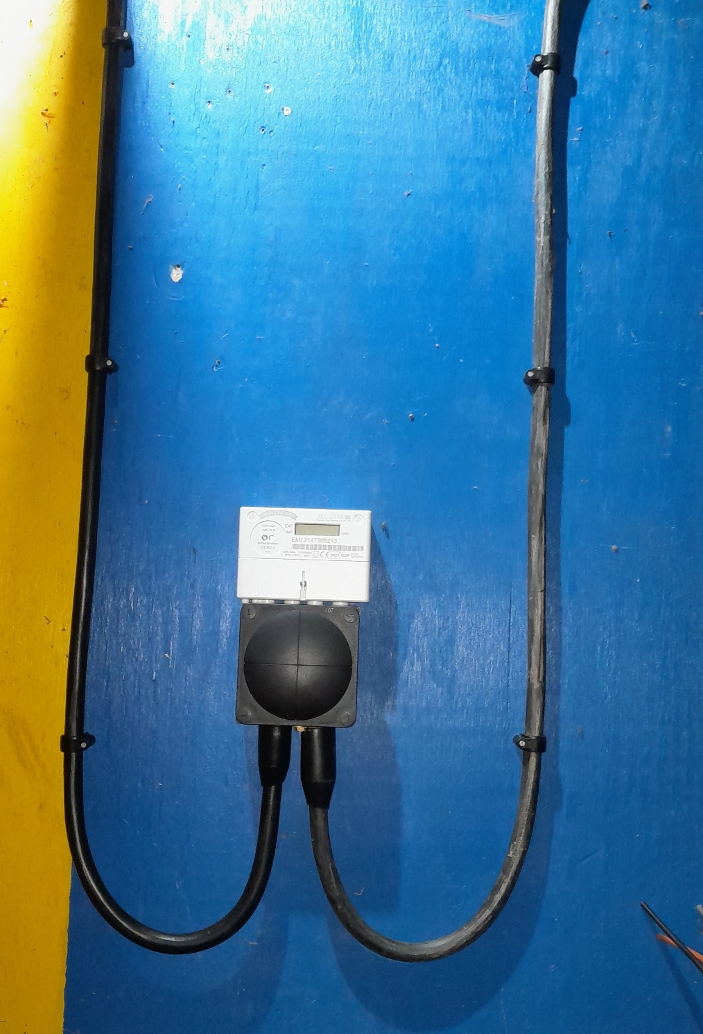

How would you have run them in? Bit of trunking between or something?
Assuming you were replying to my pic, I did it like this. Not great but it's all being taken out in a month or so. You don't need a ladder to read the meter now either. The shroud on the right is much bigger as it is for a 25mm gland. Where the one that came with the 20mm gland that was fitted I don't know, it was a new gland pack, I know this because the wrapper and all the cable strippings were left on the floor. The whole install from start to finish was isht. At least now there is earth continuity, correct polarity, the terminals are tight with the conductor fully inserted and no exposed conductor or single insulation.

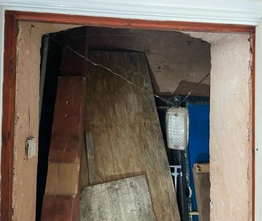

Trying to quiz a caretaker for any clues why a lighting circuit in a church is 0.5 MOhms IR.
"Any outside lights that might be full of water, or anything dodgy anywhere come to mind?"
Scratches head. "Well, there is a slightly iffy light in the slug cupboard"
"The what?!"
"There's a cupboard under the front porch, very damp, we call it the slug cupboard because they love it. The light works but it's seen better days"
He leads the way and unlocks a door that I've never been able to open.

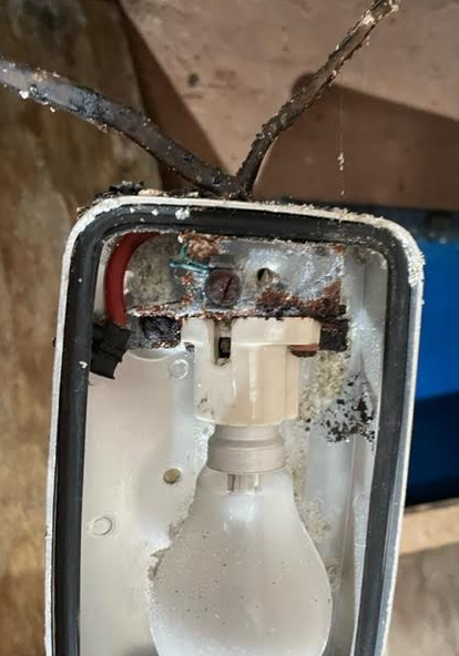

Snip Snip. 400 Mohms. That will do!

Mmm, that could be it then eh!

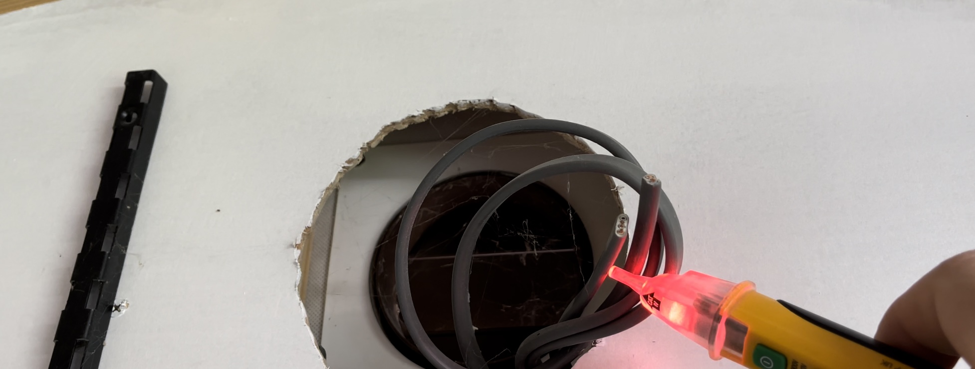

Nothing to see here. Just some cables with exposed conductors that are live. 😱

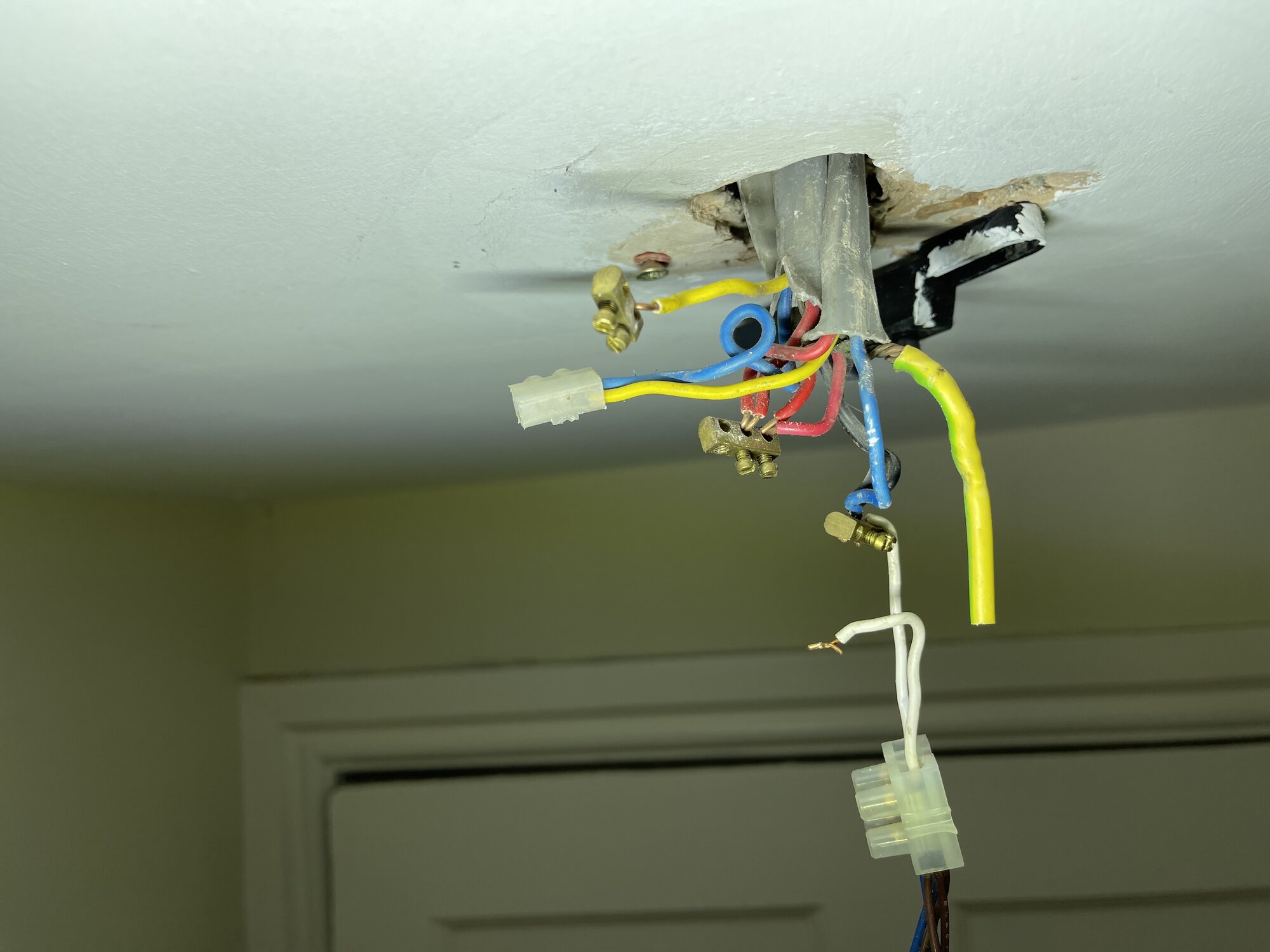

Had a call out. Old couple, just moved into a property last week. Apparently place had also had a EICR done. But I’m thinking it must be a drive by one! Given they didn’t find this issue.
Every time they turned a particular light on, which was a metal cased fitting, the electrics would trip. So told them to leave the switch off and I’d come have a look.
I go to have a look and this is what I found when I took the light down. Got ‘DIY Dave’ written all over it as I don’t believe any electrician would do that. Nothing insulated, no brown sleeving on the switched neutral and CPC just twisted together and not connected to the metal cased fitting. 🤦🏼‍♂️

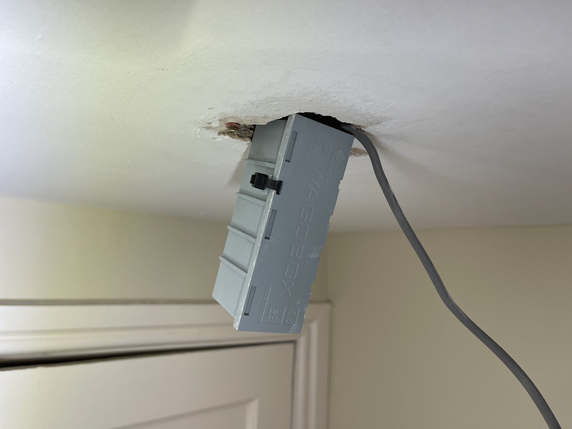

So sorted it all out and put it all into a Wago box and fitted a new light for them.
Was in a bit of a daft place too right next to a door. But they had a new light fitting that they wanted up and it just clears the top of the door.
That is the remains of a batten holder.
Yep, just found it amusing they hadn’t at least bothered to tape it up, which is why I don’t believe an electrician did it.
