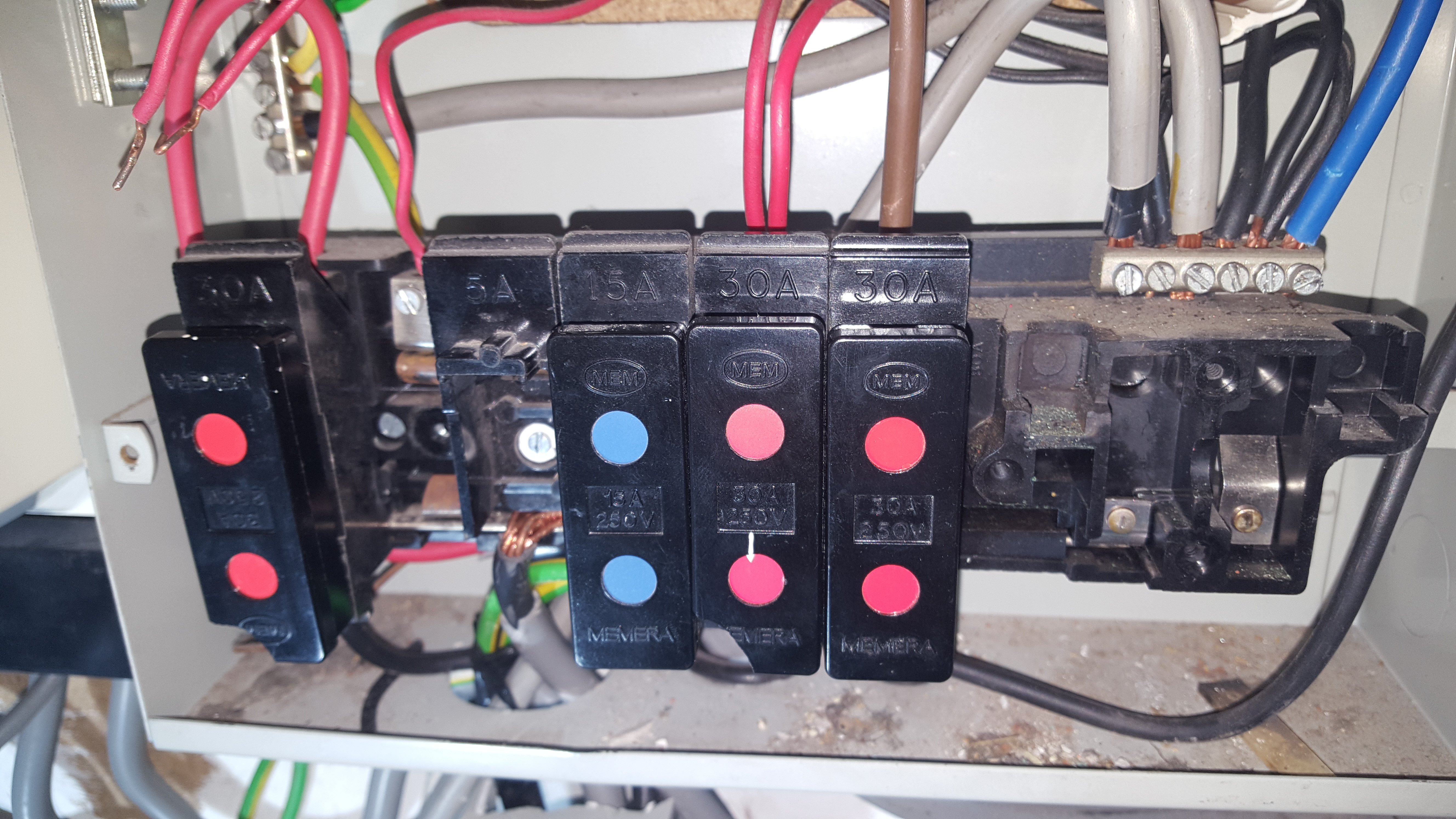

About time I made a contribution here, and this little gem from yesterday was asking for it. What's going on is:
* short T&E spurring off a socket on the inside
* connecting to a flex cable (there is actually a screwed connector under that tape, I was surprised not to find it just twist-&-taped) in the outside terminal
*from there clipped to the wall close to the ground without any protection
* and yes that's right, the flex is 2 core, NO EARTH, going to an outside socket!

That looks like PVC covered Micc to me?, it has the shrouds over the glands? The black sleeving looks like the old BICC stuff 1 & 1.5mm and that looks like the seal just poking out from the box entry in the 3rd pic?
The box in pic 1 is tagged to earth so continuity would be through copper cable sheath if it was pyro.
Having said that there is no conductor to earth pin on socket so presumably relying on cover screws for earth, an earth tail seal would have done the job nicely.

Guess it's hard to tell from the picture, will work on keeping those hands steady, but that's definitely not micc, just a flex like you'd find on an appliance. I tested before taking that old crap off, sure enough no earth regardless of where I stuck the probe around that outside socket, and the IR... Thought for a moment that my tester wasn't working, tested for IR again using the continuity setting on my tester and got 1076 ohms between L and N. The IR for L-E and N-E was 134 mega ohms (if I remember right, something around there), so wasn't hard to guess where the bad L-N IR was from!
I'm guessing whoever did that old thing had seen it done properly with micc and thought dressing up with glands and shrouds just made it look pretty? Anyway not a big job to put a new socket (the right way up!) in place with conduit back to the inside socket. Not a perfect IR afterwards, 120 something mega ohms, but that's connected to the rest of the old circuit so I'll take it.

I totally don't have time to post this as I'm in the middle of fixing a breakdown but I just came on here for a quick break way from the job and post #708 & 715 fried my brain. How can that not be MI? Granted the few inches under the socket are a bit pale and flexy-looking but, er, stub slv over flex cores c/w PVC tag on one of them? Anyone advanced enough in the trade to have stub in their back pocket and to teach flex to stay straight as a die between P-clips, will know that a socket-outlet needs a CPC.
Pics of the flex and stuffing glands (I can see the hex under the shroud) or it didn't happen.
And 'IR' of 1076Ω is an appliance or a charred wreck. 230²/1076=50W, the heat of two average soldering irons. Nothing there got that hot, PVC cable would have been on fire and burnt through.
