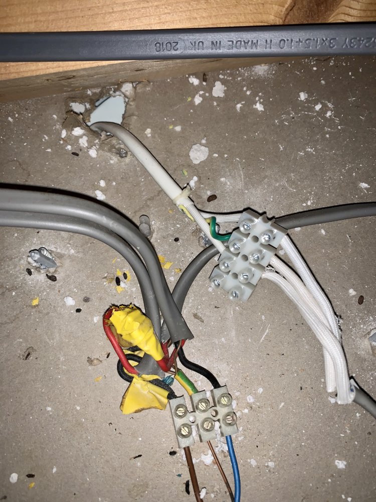

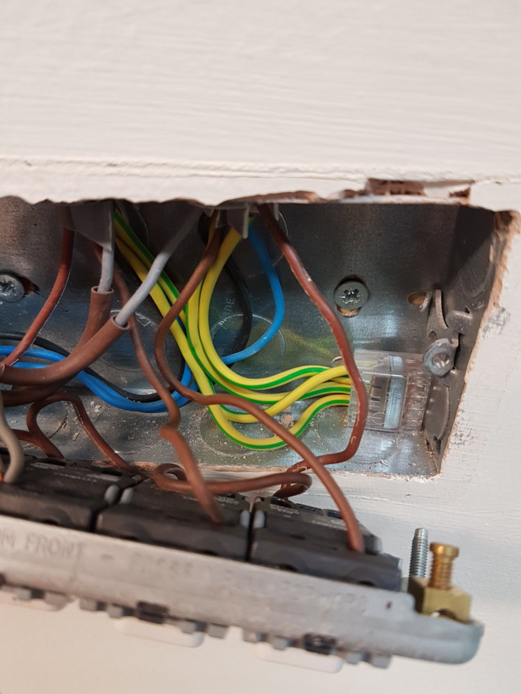

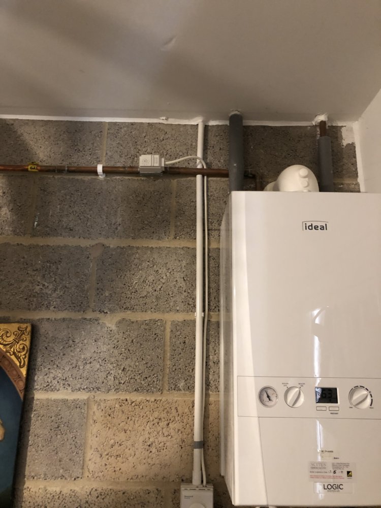

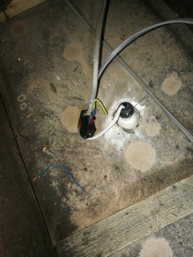

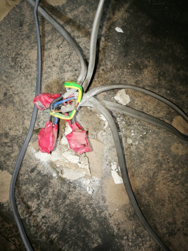

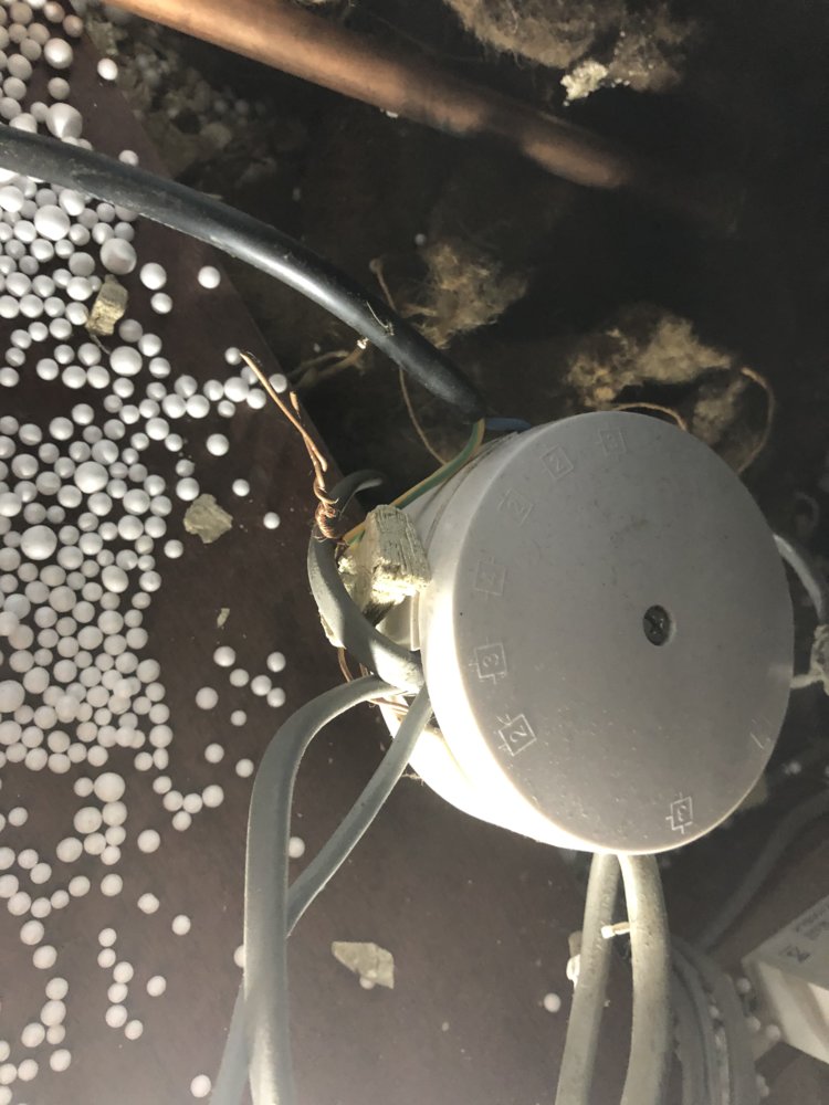

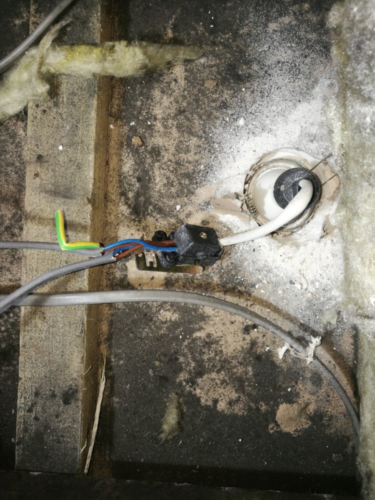

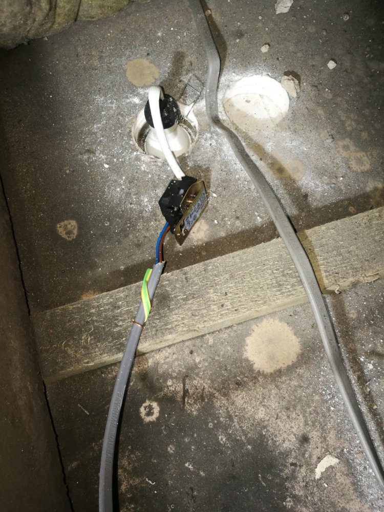

The following images are from an EICR that I carried-out earlier today. I've seen some abysmal attempts at DIY electrical work over the years and this lash-up is certainly among the worst.

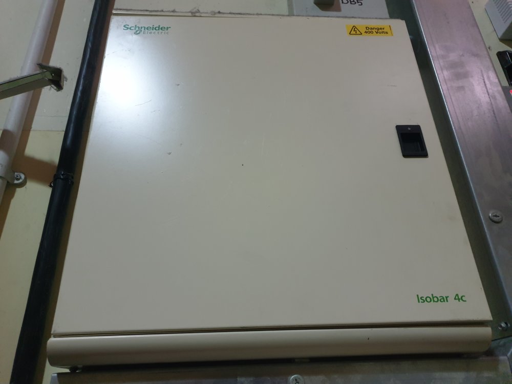

After deciding that the main switch was no longer necessary, the deranged maniac responsible for this atrocity then proceeded to choose black as the colour for the incoming live before wedging the conductor into the busbar.
And for reasons best known to himself he installed the RCD upside down. Is there a BS code for "RCD main switch, but not installed as part of consumer unit"? :D

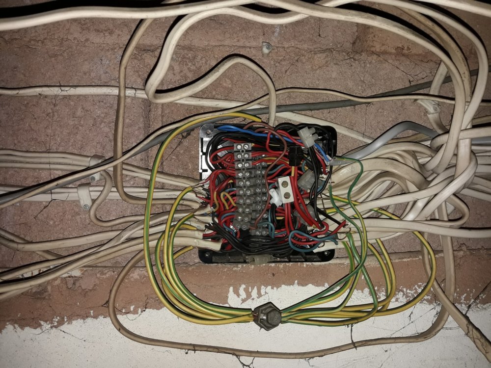

That's lethal but isn't it amazing how they come up with these crazy connection methods ?! Referring to the link 'non binary people' are obviously far more important than legislating to potentially save lives. :rage:

. . . . just when you thought you’d seen it all - priceless! Surely it would have been easier to do it properly, that just looks like hard work!
