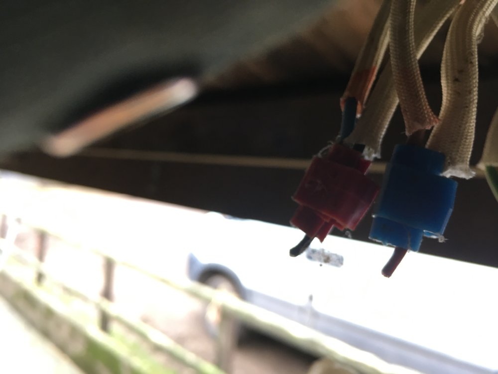

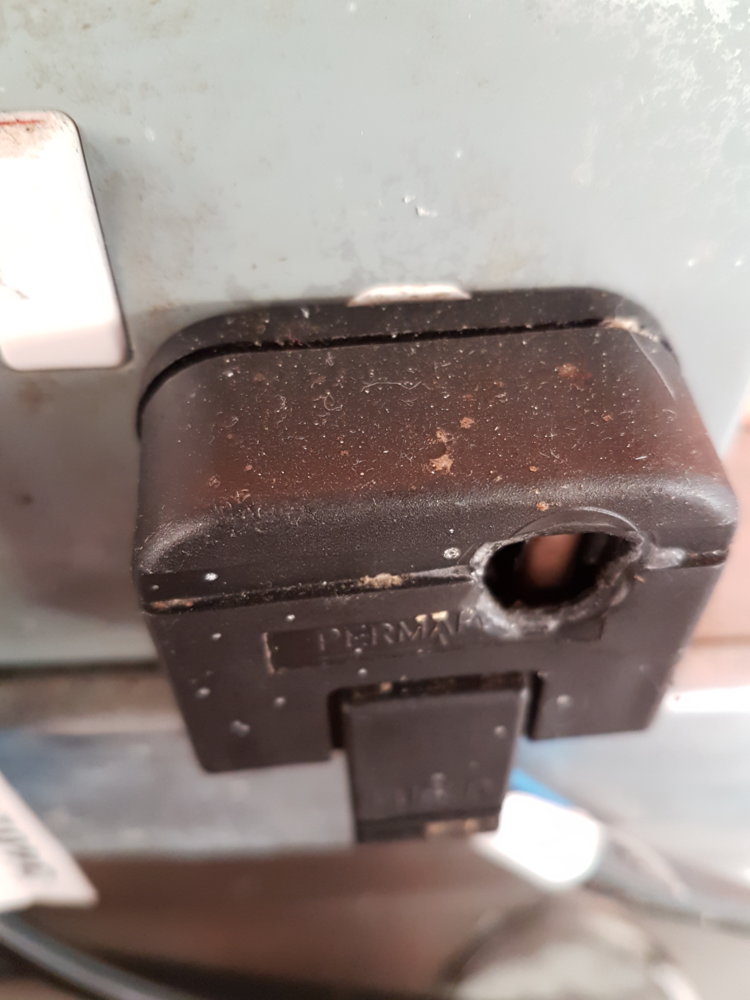

Found this today, nothing to do with where I was working. It's on a wall in an alleyway, bizarrely on the outside edge of the wall rather than on the garden side. Had volts stick to hand which detected something was likely still live, and it had another T&E coming out of it hidden from view. I was working next door though. Might pop a flyer through their door for future reference!

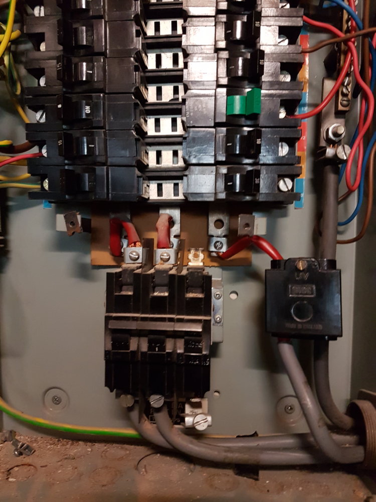

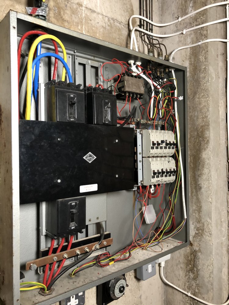

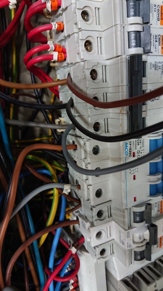

Here's a beauty for you, originally this installation would have had two 4 way Wylex boards, one for cooker,sockets and lighting, the other off peak for two heating circuits and immersion heater. [The property is a small bungalow on a site of nearly 300, built around 35 years ago].
I've done quite a few CU upgrades at this development and was asked to look at this work of genius by the owner who was having trouble with the off peak underfloor heating.
A single enclosure was fitted for all circuits [around 8-10 years ago I'm told but no paperwork and they can't remember the name...] One of the neutral tails has been removed from the block in the meter cabinet and the 'main switch' isolates the off peak live but also the sole neutral so all 24 hour circuits stop working although still live !
Apart from that timers were fitted for the 3 off peak circuits which is ridiculous and there's an interesting 'busbar' using 2x 2.5 brown singles,also cables of various sizes have been extended using 6mm straightDodgy trade pictures for your amusement! - 1 Million Views! IMG_2273.JPG - EletriciansForums.net through crimps. I'd love to know who the idiot was who carried out this atrocity but anyway I'm ripping it all out soon. :)
