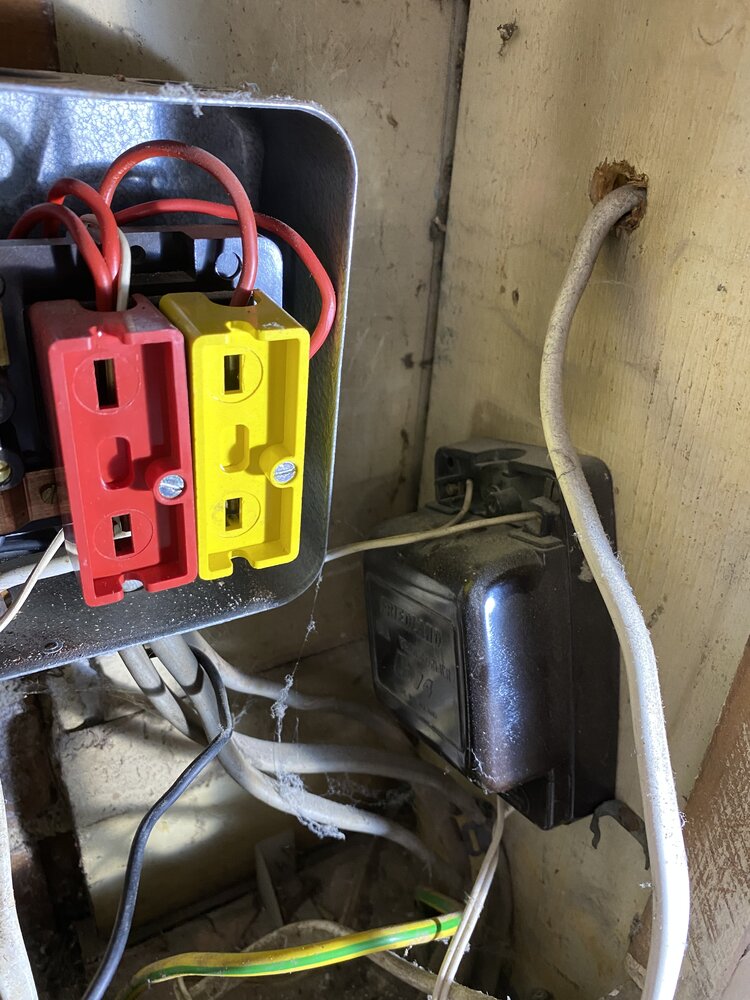

Seeing that photo reminds me of a block of 30 retirement apartments at Dunstable where the boss told electricians to wire electric UFH all through a 13A switched fused spur I had a complaint why the flats were losing heating got to first flat switched fused spur burnt out turns out the load was 24Amps!same with the next flat, well I put them on own off-peak ways in consumer unit this was picked up as a filled complaint at NICEIC assessment then the company was removed from the roll and joined NAPIT (I had left the company by this stage) so I suppose the company never rectified this a fire waiting to happen in a further 28 flats.

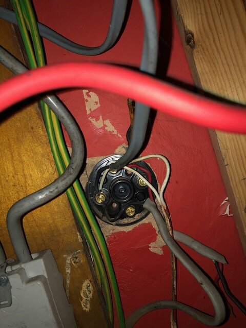

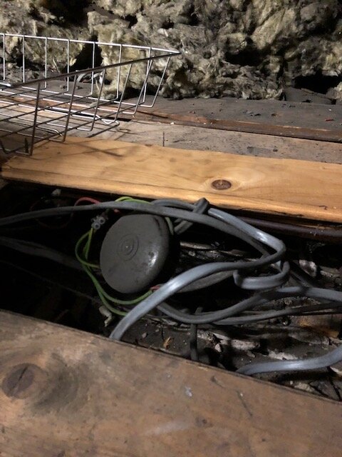

Went to fit a shower extractor fan and found the loft light wiring like this. All the earths disconnected which as they has metal light switches was doubly dangerous.
