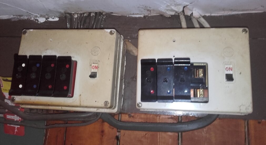

You have a meter, you have an MET!, you have a neutral bar, you have overcurrent protection you even have 300mA and 100mA RCD protection, I cant see a problem.
Oh not too sure on the OCPD for the left hand socket, but luckily the cable is in free air!:astonished::confused1::dizzy::fearscream:
Well at least they used earthing sleeve on the cpc’s.

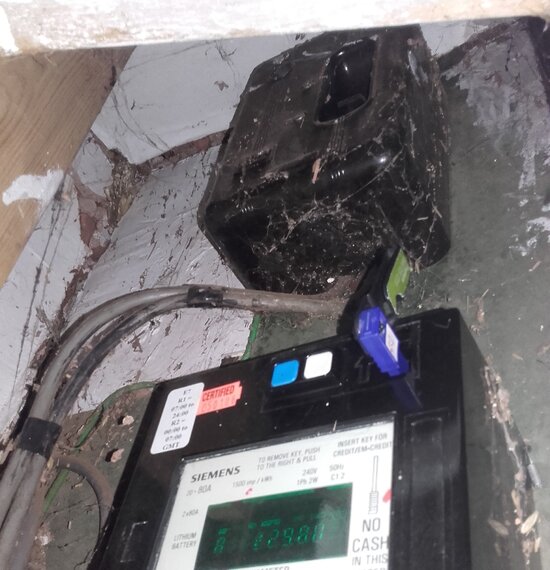

Been asked to put this right, not sure if you can see one of the cables is bent tight over the capping, this was done by a time served electrician a couple of years ago before he retired. Had a quick look at the bonding did not take long as there is none:eek: nothing on the cold mains or the oil line. No RCD, no linked main switch, no supplementary, just a 6mm main earth from the PME cutout.

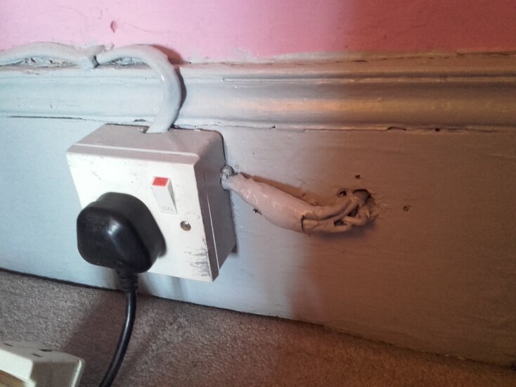

The panel is the side of a 300 larder unit so thats a cornice on the top, the sparky has chopped the caping and split the ring to power the boiler which is the other side of the larder unit and the fridge under the double socket, the t&e goes across the wall horizontally into a 20amp junction box no clips just hangs over the boiler, looks rough.
