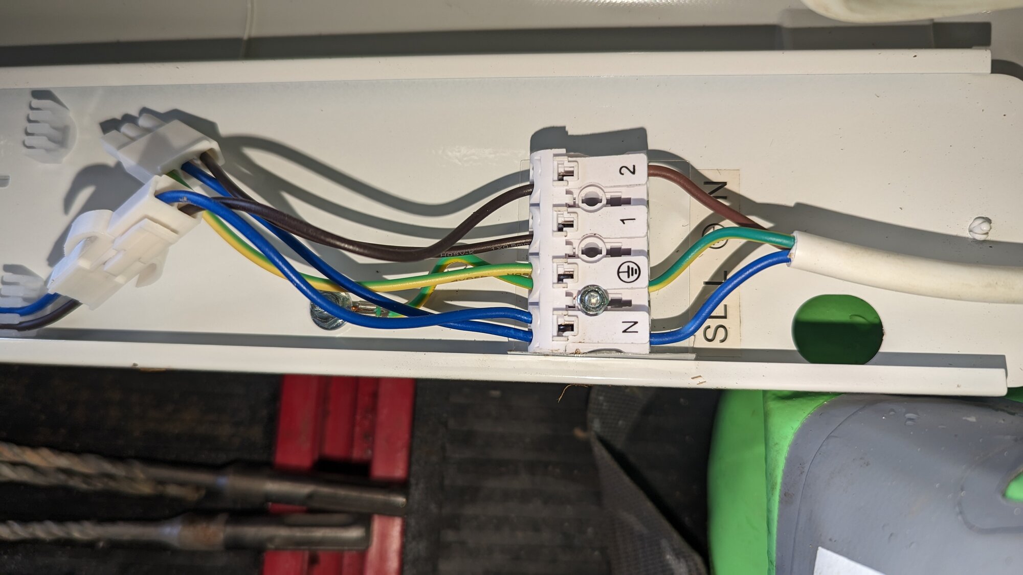

I think the neutral might have been a bit loose!
Worked in a large government building where majority of lighting was wired in blue, black and earth single, blue being phase and black neutral. The sheer amount of fittings with reverse polarity was scary.
are you sure it wasn't black line and blue neutral?
most fittings can work reversed.... its just when line somehow gets connected to cpc that things get tricky... as the upside down sticker in the picture would could lead to
Had similar last week. Building from around 2000, with emergency lighting using black for neutral, red switched live and blue permanent live. Strange thing was this was all in some sort of shielded flex, so I couldn't understand why these colours were present.
I thought it was originally but traced it back to find the circuits wired in red, yellow, blue singles with black neutral. All fittings had been changed to led and working with reversed polarity. Only realised when we went to test.
That's a strange one. Was there a yellow in it or just red/black/blue?
