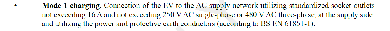

Being honest I find this confusing (amendment one):
But, happy days, it doesn't matter. Just noticed mode 1 charging says:
Note "utilizing the power and protective earth conductors"
Isn't that the answer, for up to 16A?
(Edit, but the catch-all PEN conductor ban in 722.312.2.1 still applies of course unless one of the idents of 722.411.4.1 is used. )
