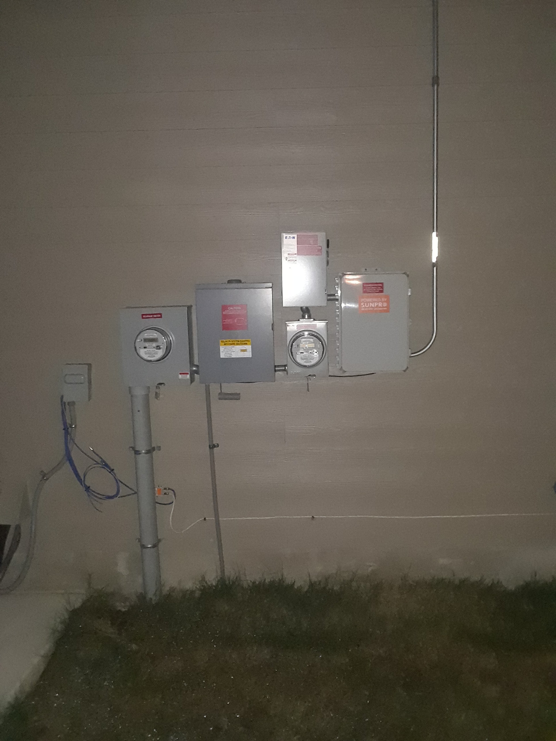

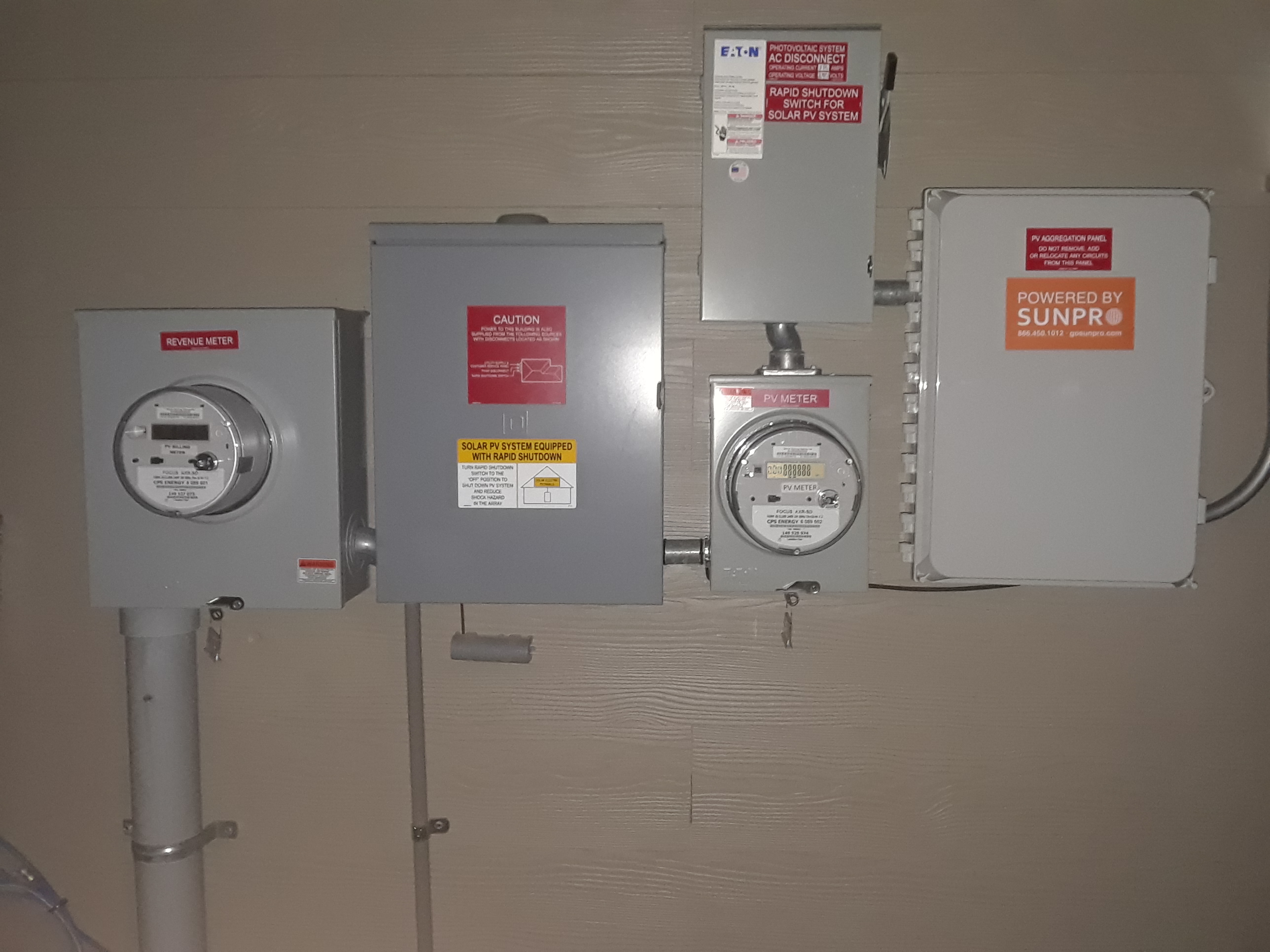

I have been trying to reconcile our electric bill with the Enphase production and consumption reports. I don't believe we have any kind of battery. There seems to be much higher production/consumption numbers on the reports that my bill and meters can't account for. The installer says that my house consumes electricity from the panels that don't make it to be registered by the meters. We practice net metering here, feeding the grid at certain times and taking at others. How can electricity reach our home without passing through the meters first...and I am talking about 100's of kWh's?
Some types of installation do in fact produce from solar and only measure the excess electricity you are feeding back to the grid.
It is difficult to tell exactly what type of system you have without some pictures or diagrams.
Please see the attached pics. Does that help? Thanks

Thank for your in depth response. Both meters are digital. Maybe the flash created the appearance of all 8's. In the end, the is supposed energy production that appears on system reports that I don't see on our energy bill that is based on the meters. I am being told the house is using energy that never passes through and is registered by the meters. It doesn't quite make sense to me, and it sounds too convenient for a company who binds itself to a power production guarantee.

Sorry if you have already had answers, but I believe from previous conversations that enphase (and similar products) take the reading from the roof, as the panels generating energy, therefore by time it reaches the meter, lossess have been factored in.
A typical install here in australia has the solar inverter feeding directly onto the house wiring in the switchboard which is after the meters. This means that you will pull as much power from the inverter as your current load requires and any excess will be pushed back to the network and through the supplier's meter. A typical supplier's meter here will only show you what you have imported and what you have exported. To know what your house is actually using from your solar panels usually requires a smart meter from the solar manufacturer installed in the middle which has a data cable running back to the inverter and between the inverter and the smart meter the two devices can work out where your power usage is actually coming from. i.e. Mains, Panels or batteries depending on your situation.
So in brief summary to your actual post question...yes, your house consumes solar produced electricity that does not reach the supplier's meter.

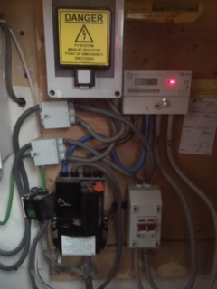

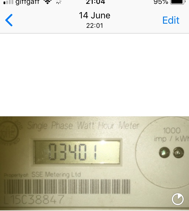

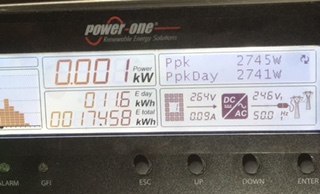

Hello,
sorry for asking a daft question. I have similar problem of not being credited from solar panels generated energy . I know exactly that my monthly usage is 100-120 Kwh from previous house.
I read your in depth post and following your logic I have used today during 7 hours in the daytime whooping 50% of solar 11,6 Kwh as recorded by Aurora inverter; and on top of it imported 3Kwh ; then magicaly exported between 10:51 and 21:10 whooping 9.2 Kw - difference of the export meter readings 17654.3-17645.1. Inverter shows etotal as 17458Kwh
Last Sunday I had solar system switched off and imported same 3Kwh during similar daytime routine ( I am autistic AS/combined adult ADHD).
One bed, one person , no TV , music players etc; kettle boiled once, 3 ip cctvboiled 1, toaster used 3 times, Whirpoll 6sense microwave 35 min crisp option, Tower airfryer 20 mins 200C, Tower electric pressure cooker 20 mins two washing cycles in Samsung. Constant use Kenwood fridge/freeze A ratings on most appliances; lights led/low voltage on when entering the dark area, phone charger, laptop use.
I might loosing something but this doesn't make sense or math . I attach wiring of the solar with export meter and my electric dashboard with grid meter, and meters readings for illustration.

I do accept my limitations of technical knowledge , Ons laws application fir alternating currents and social reasoning hehe.
Solar export and consumer import are two entirely separate processes .
They are recorded by export and import meters and financed separately.
As you can see on my photo there is no sign of a magic power mixer that blends inverter raised higher voltage for injection in the grid and imported lowers consumer voltage energy .
Therefore no way I can use higher voltage solar for running my appliances even theoretically . Because they are fused to prevent damage in case of using higher voltage power .

Just be clear... Your inverter creates power at the mains voltage for the whole of your house. If you have 2kW of Solar and you put a 3kW kettle On, the house will draw the extra 1kW from the mains.
No magic box... Just the inverter... A length of copper wire.. The consumer unit. Where your solar along with your kitchen circuit are connected... The other side of the consumer unit is connected to the mains via a big 60 or 100Amp fuse....
When you are using all the 2kW solar you do not have any excess solar energy to export but the kettle needs 3kW, so it takes that from the external mains at the same voltage.
No magic mixing device just 2 supplies to the kettle. If anything the copper wires mix the power from the solar and the mains together.
