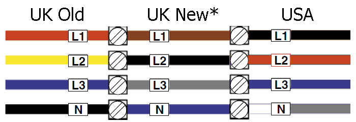

In the good old days when we used red blue and yellow it was obvious which conductor to use for single phase cpc and which for the phase and neutral. These days it is not so.
And the question is, which colour do you choose for a cpc on a single phase system wire in three core brown black grey?
You can use any you wish as long as it is correctly identified. Even on the old colour system there was nothing cast in stone to say the yellow can be utilized as the cpc, people saw yellow as being akin to green/yellow and blue as neutral as in flexible cables/cords with the yellow occasionally sleeved and the blue left unidentified when it should have been black.
Grey-neutral
Black-CPC
All cables must be identified each end and at any JBs along the way...

Grey-neutral
Black-CPC

Where is that conductor usage stated?
I think green/yellow looks better on black
and blue looks better on grey.
but always verify with tester, never trust a bit of tape.
