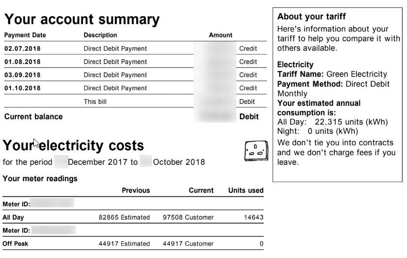

We moved into a new flat about 6 months ago and have realised we're being billed for all of our electricity at the expensive "all day" rate - despite having a very large "Thermaflow" electric boiler which is designed to draw tons of power heating up water overnight to use throughout the day.
The flat has an interesting wiring setup for Economy 7 which I hadn't seen before - there are two meters (one "off-peak" / cheaper rate, one "all day" more expensive rate) and a Horstmann radio teleswitch which I believe is supposed to control the usage of the lower rate electricity.
Of the two meters, the "off-peak" one hasn't moved at all since we moved in - clearly everything is going through the all day meter.

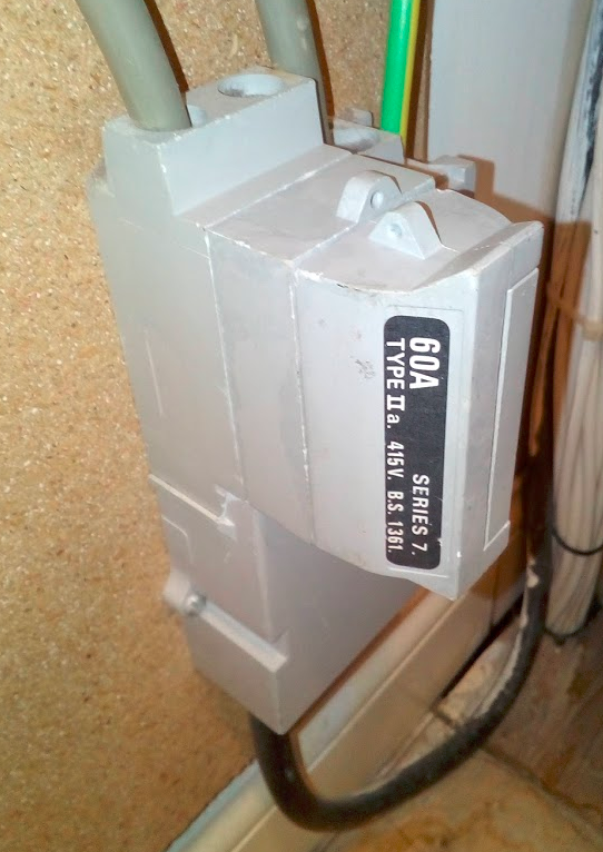

Photo:
drive.google.com/file/d/1SvlaB1YaVGVI-cbTcr4wbCMoLfYM7Www/view
My understanding of it based on googling lots and reading is that the teleswitch (controlled by AM radio signals) is supposed to turn on and off during the night - essentially opening or closing the chunky 80A mechanical relay to allow current to flow during the off-peak times.
From my testing with the multimeter it seems like this relay is permanently closed in our teleswitch, yet no current is actually going through the off-peak meter.
I don't really understand the way this is wired up - from what I can tell it looks like all of the load (consumer unit + boiler) goes through the single Wylex main switch, which is connected directly to the live load output on both meters! As such, I don't see what would control which meter the current would flow through - I'd actually almost expect it to be split between the two, though I guess a minor variation in resistance between the two paths could cause it to pick one vs. the other.

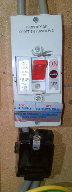

Your homes' electricity is indeed being supplied through the normal rate meter on the the right hand side. The problem lies beneath the Wylex switch disconnector. It has two meter supplies going into it at the top - on the left is from the right hand meter and on the right from the left hand E7 meter/teleswitch. Beneath this switch there is only one output - from the normal rate meter which goes in to the Henley block and then off to the CU and the MK thermaflow board.
To obtain E7 for the thermaflow the Henley block I just mentioned needs to be removed and then the CU fed from the left output of the disconnnector and the thermaflow from the right - but see below at ###)
So, the way you've explained this seems to me that I may have made a crucial, incorrect, assumption about that Wylex switch.

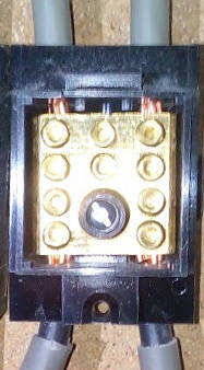

Because these little Henley connector blocks simply connect all inputs to all outputs:
I had assumed that the Wylex switch also did the same, so wasn't really sure what determined which of the two meters that current would flow through.
However I believe you're saying that despite there being only one on/off lever, this Wylex switch is actually acting as two switches, for two isolated circuits, which just happen to be controlled by a single physical lever?
Therefore, because everything is connected to the left side of the switch at the bottom, and nothing on the right:
There has never been anything connected to the top right cable at all?!
:hearnoevil::electricplug::bomb: ... well, that would certainly explain why no load has ever gone through the off-peak meter!
Assuming the above is correct; thank you so much for pointing this out to me - I now know the cause of the problem is indeed wiring, and know what needs to happen to fix it.

The disconnector has been labelled at the bottom to indicate the nature of the outputs.

As a side note, it looks like the only way to isolate that switch properly is to pull the main fuse, which in theory is supposed to only ever be touched by the DNO (not even a local sparky), and is meant to be sealed to prevent tampering.
However, ours isn't sealed:
