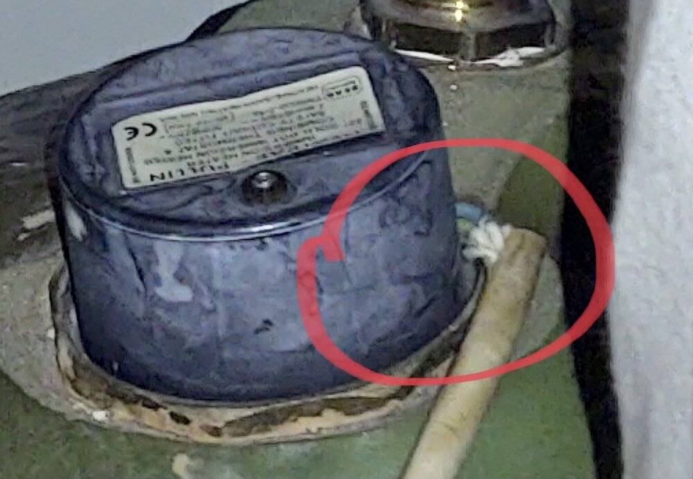

This is SE England so part P applies.
I noticed the insulation on that immersion heater too (mentioned above in my rant lol) and will fix that, luckily no exposed conductors but agreed it needs done now.
Thank you for confirming that the earth is ok on the 6mm, I will advise when we next get opportunity to upgrade the earth to 10mm, as I'd feel better personally.

Is the main water stopcock in the same cupboard? Checking that the bonding is present to pipework just after that and to the gas is really all that is necessary these days outside of bathrooms, though you also have to watch out for a pipe then going back into the earth (or a concrete floor), as it then needs bonding again where it re-enters the property. It's the introduction of an earth potential that you're looking for.
If by any chance you have a certificate from when the consumer unit was installed, then it should have checked these things and might give you some peace of mind. If not, then an EICR at some point might be worth the investment to be sure there are no other hidden nasties.
Insulated fittings often mean that the pipework after it is no longer extraneous anyway.
If you really wanted to test something to see if it is an extraneous-conductive-part or not then it's tested between the part in question and back to the main earthing terminal, and it's a different formula (some details here if you want more bedtime reading) - at which point you're looking for more than 22k Ohms to confirm it's not extraneous-conductive, or less to say that it is.
I'd say if you fix the immersion now, and upgrade the lighting MCB to an RCBO and perhaps the main earth and main bonding to gas, then you've done everything reasonable to make the property safe for a good while into the future (Type A RCDs and that issue aside).
