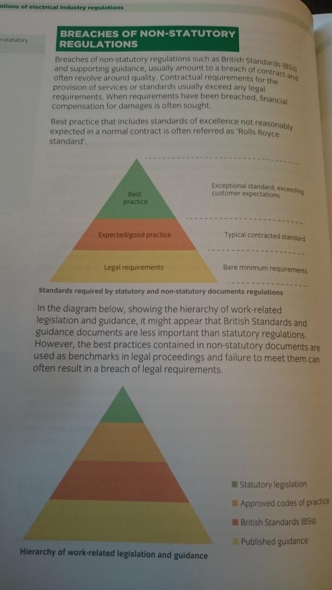

As someone just starting out, the guidance notes are an invaluable source of knowledge, in terms of interpreting the regs and stating what [the IET thinks] is best practice. If you can't cite a source for a statement, it's pretty low value.
They even teach you about this sort of thing on the level 2 course...:
It continues... "This will lead to the statutory enforcement system and criminal courts. For example, a breach in the non-statutory IET Wiring Regulations may have a significant effect on safety and ultimately result in a breach in statutory legislation.
Even if a breach in non-statutory regulations is not a legal issue, the consequences can be far-reaching. The industry may lose faith in the offending organisation's ability to perform, resulting in a loss of customers and tenders. In the case of the rules of trade and similar organisations, breaches may result in expulsion from the relevant organisation."
Quoting what someone said on an internet forum (unless they cite a suitable source) is off the bottom of the triangle ;)

it seems questionable how the Regs could hold up in court with Regards to bonding and Earthing when so much of it is so unclear with Hundreds and Hundreds of Questions on bonding and earthing on the Net another hundreds and hundreds in the classroom, surprised someone hasn't considered taking action the other way round.
it seems questionable how the Regs could hold up in court with Regards to bonding and Earthing when so much of it so unclear with Hundreds and Hundreds of Questions on bonding and earthing on the Net.
The regulations aren't really very unclear, their language is usually pretty precise.
The biggest problem is people reading the regs who don't understand the correct/proper meaning of the words used, or who have a preconceived idea of what they think should be written there so they try to force what is written to fit their ideas.
with respect that's like saying Hieroglyphics aren't unclear people just don't understand them
and if that is the case they need to be writen in a clear manner, I would argue that no it can't be used as evidence in court regarding this subject because quite simply no one understands it and saying well I understand it - I don't think is acceptable, being careful what I say here but quite simply it's not safe, and maybe put people at risk on this one subject.
