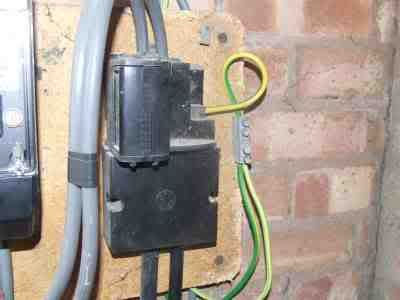

First example, is it a TN-S or a TN-C-S or both?
It kind of looks like TN-C-S, plus an extra earth to the incoming cable sheath, as if the supply was once TN-S, but perhaps has been converted to TN-C-S?
Ten out of ten for SJD!
Yes its in an area where the DNO is installing TN-C-S to all the houses so at the time of the picture it was both so they could switch over without disconnecting an earth path from anyone's house. Just a good example to get the ball rolling on this thread.
If you have a neutral connected to an installations earth terminal (eg PME/TNC-S) then the incoming supply cables metallic sheath connection must be disconnected. Especially important where a supply cable is suppling both TN-S and TNC-S earthing arrangements!! eg, ....where the DNO cable is in the process of being PME'd....
TN-C-S
Another obvious one, were is the earth cable going? Ho to the main fuse therefore its a TN-C-S. C = Combined.
TN-S , paul, not TNC-S.
Predicted text Tel lol. Now edited and me looking like a muppet again :).
@ E54, the DNO "forgot" to come back and disconnect the TN-S. A Ze was taken on the pme to establish continuity before my snips came out. I also called the DNO to make sure, now that's twenty minutes of my life that I won't get back.

its got to be an old tns changed to a pme but if think there its been left like that cause of corrosion to there incoming cable
