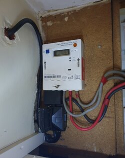

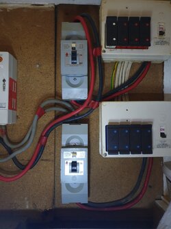

We like pictures. Can you post a photo that shows the intake with the suppliers fuse, metering etc. Perhaps also the consumer unit / fuse box while you are at it. Ideally one for each flat, but appreciate you might not have access to the upstairs flat.

Hi, thanks for your reply, no I don't have access to upper flat, it is currently empty, do not know when owner next there. I have added two photos of my meter.
It doesn’t look like you’ve got an earth either… not saying there isn’t one, but it needs checked over by an electrician.
The meter looks fairly modern, so I wonder why it was put in without an earth??
The earth wire is a safety feature and everything would be working as normal, until there was a fault… then something that should be earthed becomes live and doesn’t blow a fuse… because there’s no earth.
Something like your kitchen sink.
It’s dangerous not to have an earth.

Hi, thanks for your reply. we were not aware of no earth in the property, having spoken to the previous owner last night of the upper flat, they also were not aware of having no earthing in their flat, and we have all occupied the property for over 20 years. The meter is fairly modern was changed about 10 - 15 year ago. The new owner upstairs had an electrician check the property last week, they want to install new earthing spike back of our property for the upper flat, they will also install one for us ground floor. From your reply it appears we also have no earth, I am just glad to clarify the situation so the property is safer to live in.
We’re not saying there is no earth for definite in your flat…. But it needs checked.
An earth spike can be put in for the upstairs flat, run down the external wall, no need to come into your flat unless they’re doing yours as well.
Get it checked, and if it is found that you have no earth, have a word with your supplier as to why it wasn’t noticed when meter was changed.

I would be thinking of a new consumer unit myself. Rewirable fuses are so retro 1980’s

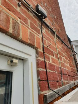

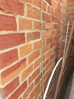

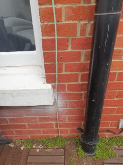

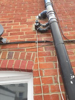

We recently had a new smart meter put in and the electrician said we did have earthing. Looking out the back wall there is green yellow wire which runs in line with the fuse box via inside the wall, this he confirmed was the earth cable. It was not discussed about upstairs flat as I failed to mention on the day, however on the opposite side, back wall again there is a yellow green cable, runs down wall into ground. I have shown images here of both cable, presumably this would be upstairs earthing cable? They say they don't have any earthing so wonder what this other cable is running next to water pipe?
First 3 images here is my earthing cable right side back of flat, next 3 images is ? Earthing cable left side of flat possibly upper flat earthing?
