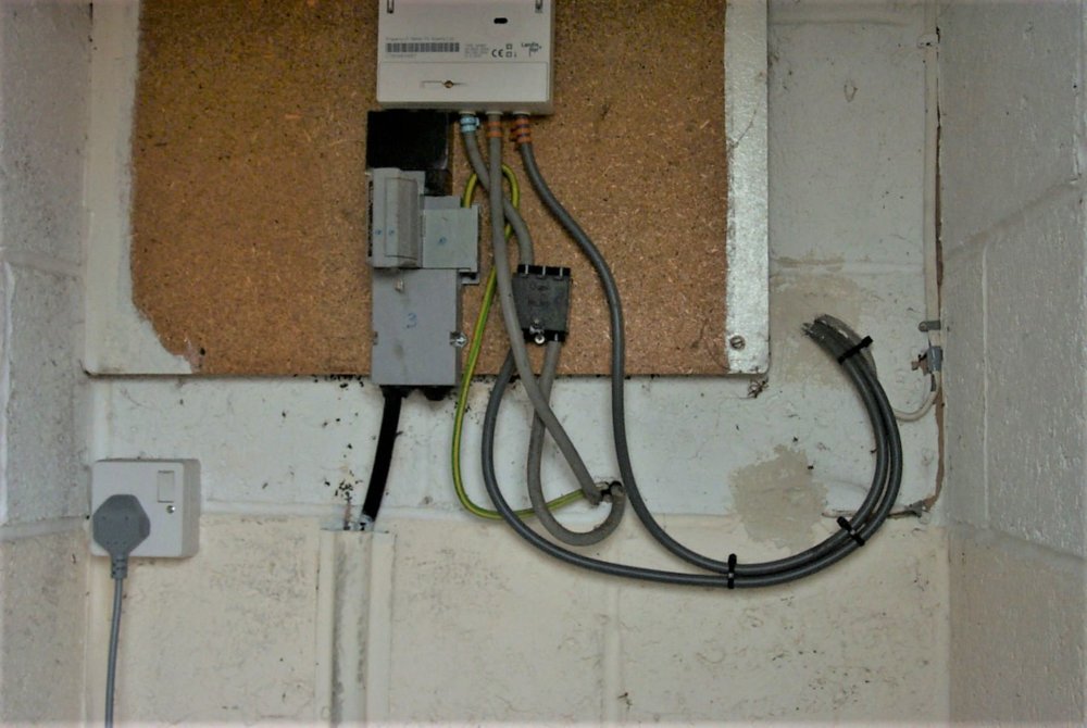

Can somebody tell me what type of earth and where is it connected to ground.
Can I have an independent earth bonded to ground for my Amateur radio equipment? Will this earth need to be connected to the domestic earth, if so can it be connected via an RF choke to prevent feed back to domestic equipment.
looks like pme to me. the earth connection is via the suppliers incoming cable, staked to earth multiple times along it's route.
That's PME, which is TN-C-S ; the primary earth is in the substation, but the combined neutral/earth conductor will be additionally earthed throughout the run from the substation to you, at which point the earth and neutral are separated and are now different wires throughout your property.
If you have any transceiver equipment, this will be earthed via this earth (cpc) wire when plugged in to a socket outlet.
As to earthing for your antenna, this really depends on the type used, and the equipment you have, sometimes they are regarded as separate, but within your transceiver there is usually an interconnection designed specifically for this, if you provide further earth connections, you may very well be bypassing this, plus sections of your atu if there is one.

Given its PME, and this is becoming the most common arrangement, I would expect rsgb to be able to provide exact guidance

Thank you all for your most helpful comments. It is a 2 wire system, L - N with the neutral bonded to earth at several points along the run from the substation. At the domestic property this 2 wire system opens up to a 3 wire L-N -E. Not realised that, you learn something every day.
How can I find out where my nearest neutral bond point is?

It may sound a bit picky, but the terminology is important here, the cable from the substation is 2-wire, but not line-neutral, the combined neutral earth wire is just that - CNE (combined, neutral, earth) not neutral so line-CNE or L-CNE, they separate out within your property - in your case the grey box thing below the meter.
The distributor earths the CNE wherever the guys installing it decide, so depending on the nature of the ground conditions, at every split off to each property, every second, third... whatever.
If you have metallic gas or water pipes entering your property, these should be bonded to the MET, so these would actually end up being the closest bond to the local earth.

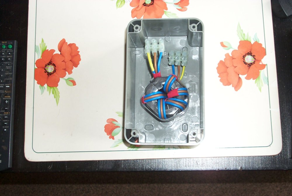

Thank you all again. I plan to use a common mode choke on the incoming supply to the radio shack ( a 2,5mm spur directly from the CU), winding l-n-e onto a toroid (about 8 turns) I wondered if there would be sufficient isolation from the PME as I have no idea where the neutral/earth grounding point is! I have asked the network provider for this info and they have refused to tell me! - as I have no need to know! So to be sure can I (qualified electrician) arrange for the MET to be connected to ground (10mm conductor) via a 1m rod driven into 'Terra Ferma' adjacent to the incoming supply.
Using a common mode choke on the supply makes a lot of sense. You will need a big toroid (one of the 60mm or more internal diameter) and apply a bit of sense to avoid damaging the twin & earth by excessive bending. Also you might want to de-rate it a bit due to the reduced ability for heat to escape (maybe just a 16A breaker, probably more than you should be using for the shack anyway). If you can't get enough turns on in any sane way, just use a 2nd toroid to increase the series impedance.
