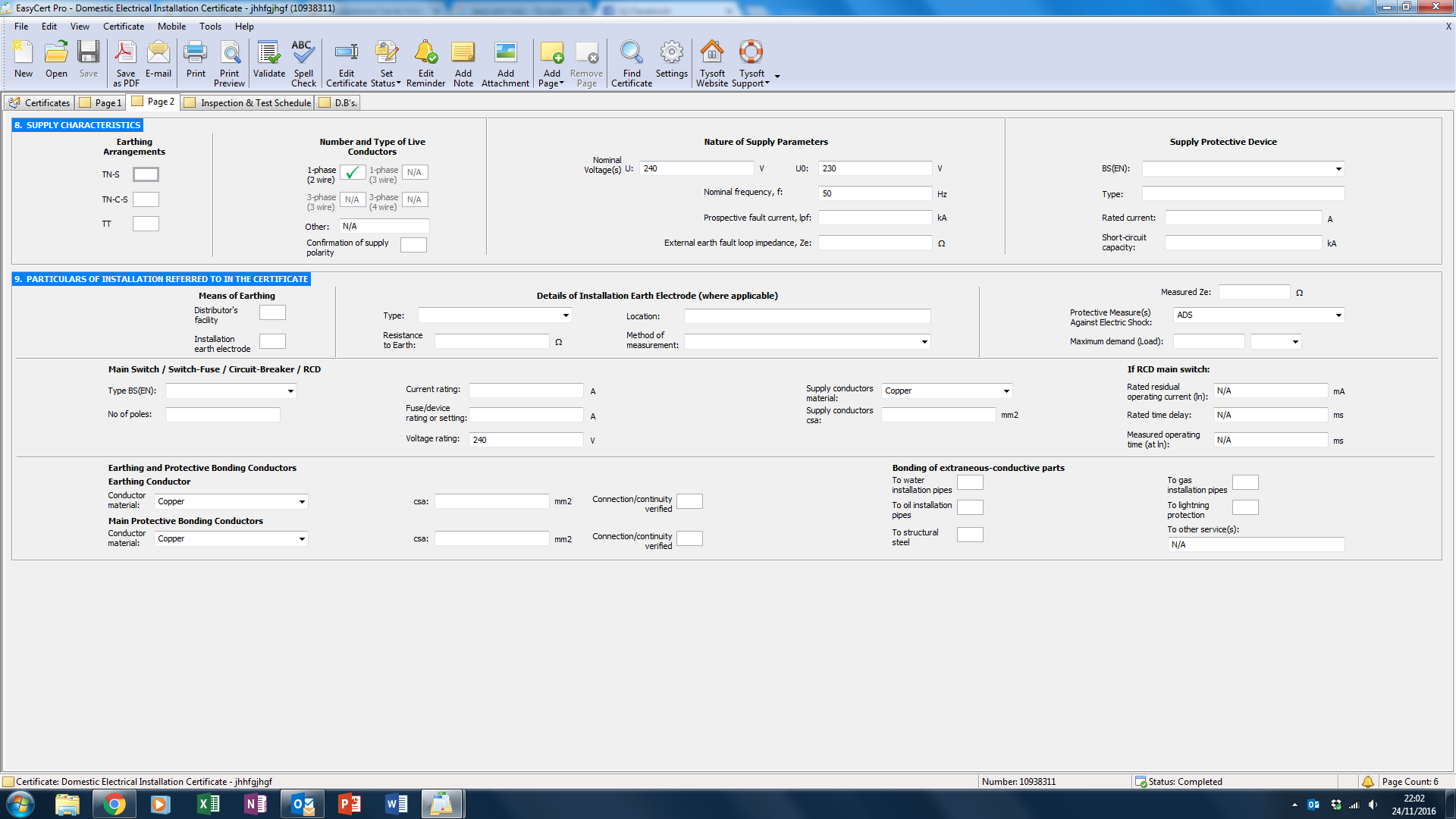

On the Domestic install cert on here I think Im confused.
Section 9 says "Particulars of installation referred to in this certificate"
The install done is cutout-meter-Henley.
One connection of Henley goes to house board.
Other goes to a KMF which feeds a armoured which feeds the board in the garage.
From that board is a 50a mcb feeding a cu in the shed.
In the shed is a 32a supply for a hot tub and 6a for lights.
Ill be filling out 2 DB pages - one for the addition of circuit from garage cu to shed, and another for the cu in the shed.
In section 9 its asking for "main sw/circuit breaker/switch fuse/rcd"
Which one is this one? Also asks for the sizes of main bonding conductor and earthing conductor.
I was told on another forum that section 9 is the incoming supply but is it? with questions like that - to me it points at the board in the shed that im fitting.
Or would you just do 2 seperate certs - that was section 9 would be relavant to each part - ie main sw of the shed board and main sw of the garage board?
Any help appreciated....
