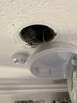

Doing a EICR today and every bloody smoke detector was installed about 100mm away from the light. Conventional FA System with series 65 Smokes and Heats. I know building regs say 300mm distances from lights and walls. I know Aico mains smokes instructions say 300mm from walls and lights but I can’t find Series 65 instructions online or anything in 7671. Ita more to note it than code it as the fire alarm bloke should be picking it up on his 6 monthly inspections but isn’t.

For a Part 1 system it is 500mm from walls and similar obstructions.

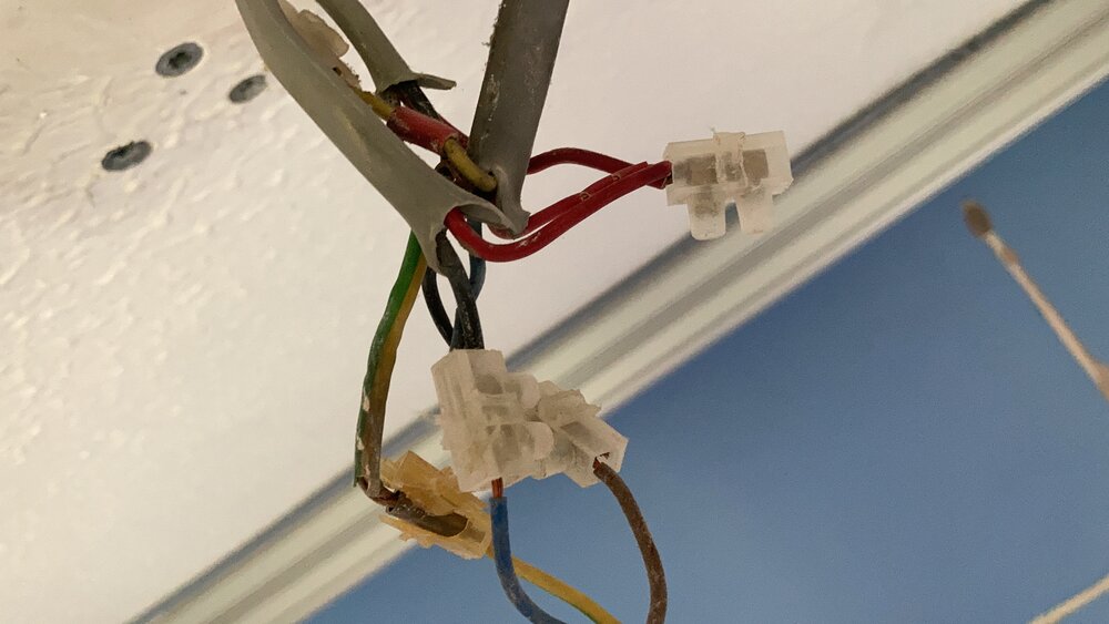

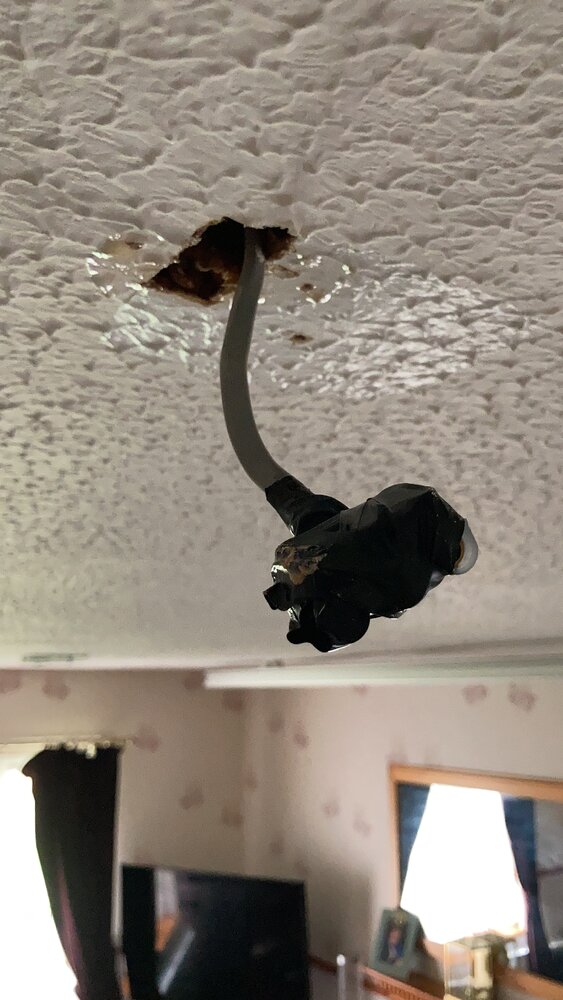

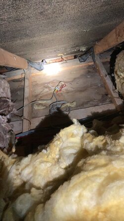

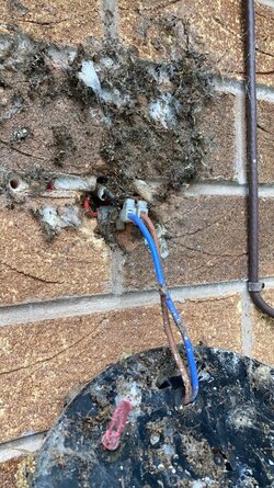

Some photos of the lighting circuit on the EICR I found. Didn’t get a R1+R2 at every point surprisingly enough.
