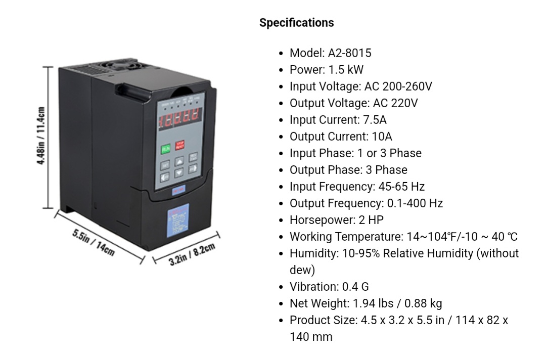

Unfortunately it doesn't ship to usa however I found a similar one but it says "The input for this VFD is 1 or 3 phase, and the output is 3 phase. Should I be looking for one with Single phase output not 3 phase
This is the spec for the one I found
Thanks Fazz711
Yes look for single to single.
Either that or look for three phase pump.
Which would be more efficient.
I have never come across a decent single phase to single phase speed controller
if I was doing it, I would be Looking for a 3 phase motor and a single phase to 3 phase inverter
I could then buy a decent quality system and not have to worry about the effects of capacitors and how they interact with a vfd drive.
