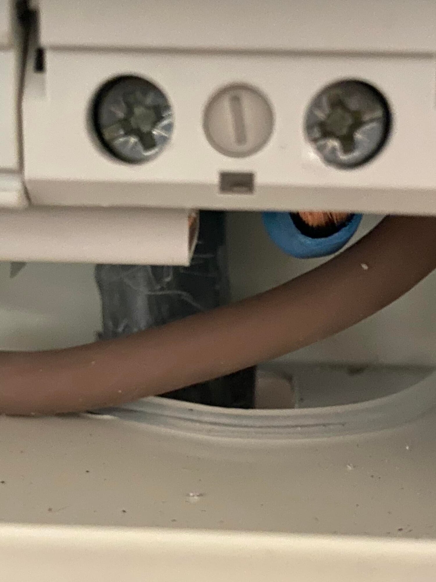

I wonder if theres any good experienced electrician out there that can help me in enfield EN2 area with a problem. Im getting light electric shocks from all the taps (copper plumbing) in the house when i stand barefoot. even when the the main fuse is switched off. The shocks are very mild. I had an electrician come over but he couldn't fix it. The DNO did some test on the main power cable and the readings were fine according to them. If you are around Enfield please contact me.

It's my own property and the DNO changed the main wire thats coming in to the property this morning but the problem continues. When the electrician removes the earth thats coming in from the outside it solves the problem but again that earth has to be connected. Please see attached pictures of the recently (moved outside) meter, fuse and the fusebox inside. If there's anyone in North London with experience that can come and have a look please contact me. Thank you.

You shouldn't be getting any shocks or tingling sensation, someone has missed the fault.
How long has the problem been going on?
Was the problem there before the meter was moved outside?
Has any other work been done inside or outside your house or at any of the neighbours or in the street outside recently?
Did your electrican or the DNO measure the voltage on the pipework?
Judging by the 1st photo at least you aren't paying for the electric for the shock, the meter is bypassed.
Where does the cable on the right go to, presumably the consumer unit (fuse box)?
Which cable did the DNO replace?
Bought the property last year and did a full refurbishment. The problem is only there when you stand barefoot on tiles or ground and touch the taps/radiators or water so it's very difficult to tell if the issue was there before the works. The problem has been going on for nearly a month now and yes the problem was there before the meter got moved outside. The electrician measured the pipework and can see that theres a low voltage 3-4 on the taps. DNO says that the readings of the main cable are just fine.
So you are basically saying that the meter is not working cause the wrong wiring?
Correct.
DNO replaced the cable thats going from the meter outside to the fusebox inside (The cable on the right). We thought that maybe that cable was damaged during the refurbishment works but clearly that's not the case cause the problem continues.
As @snowhead says your meter is not connected to that outgoing cable.
Can you take the trunking lid off below the consumer unit because I suspect the armour of that cable is not earthed.
Thank you for the clarification and i do understand now. Please see attached. I hope the pictures are clear enough?

If I wasn’t paying for electricity, I’d just put up with a slight tingle. Wear rubber shoes when on the tiles. 😄
Why have they connected it like that? Direct off the fuse, not through the meter?
