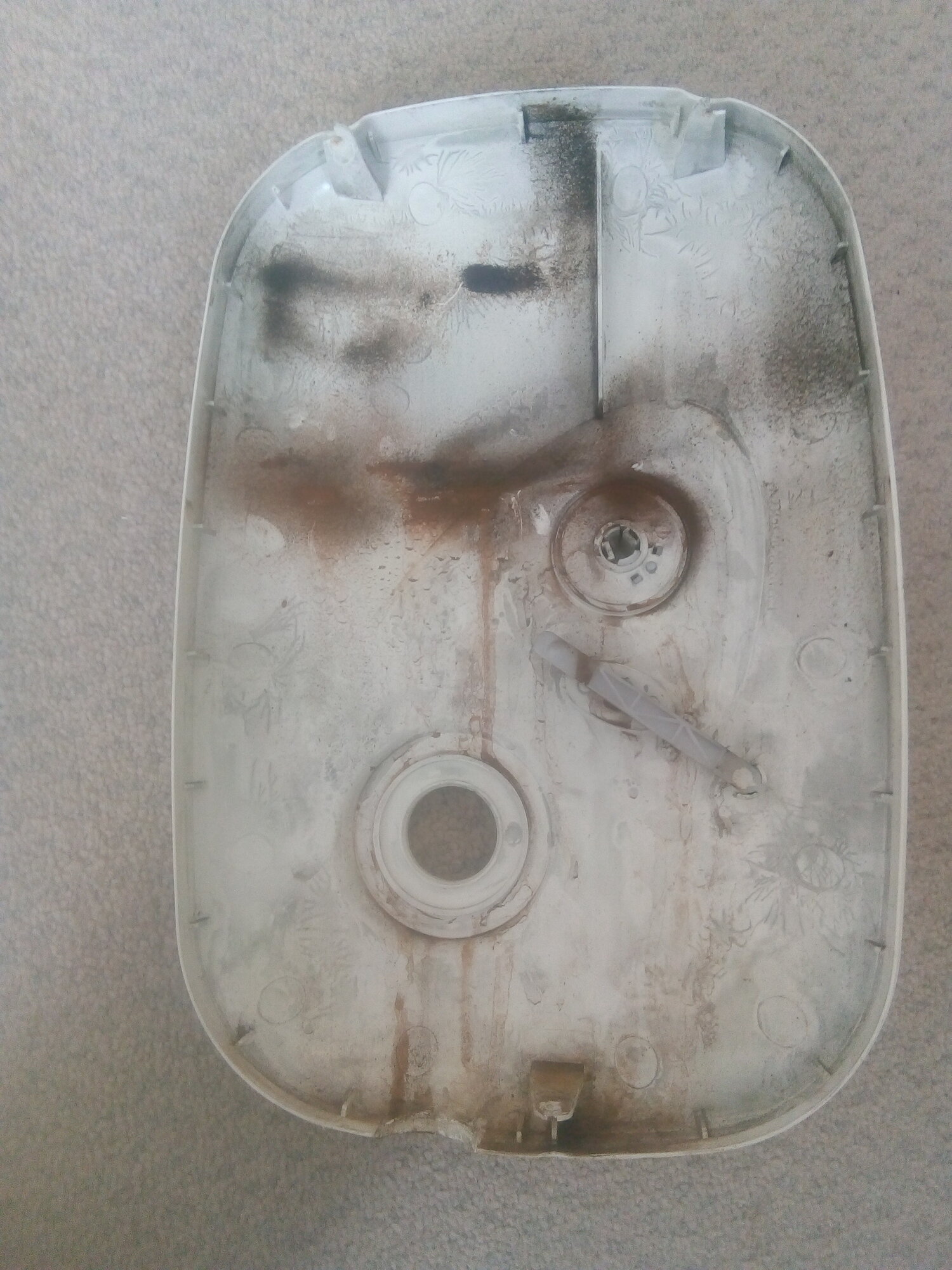

Hello,
I have just posted in the Electrician's section one photo and two videos of what I believe to be a dangerous situation of short circuits happening within a shower unit.
You can see (also here attached):
1) Extensive burn marks on the plastic cover;
2) A vast amount of water leaking from the round attachment surrounding the hose, in the lower part of the unit;
3) A vast amount of water being trapped in the shower unit
In another video I hold it is possible to hear loud popping sounds at all times, when the shower is on.
I am not an electrician and I would greatly value feedback from qualified electricians on this matter.
I believe the visual evidence demonstrates that the presence of short circuits and therefore of a dangerous situation.
A qualified electrician, before replacing the unit, also described the situation as extremely dangerous.
However, the RCBO never tripped when popping sounds and internal burn marks were being generated, nor did it trip when the shower was leaking so abundantly.
My landlord denies even the possibility that the one described could be a dangerous situation, because the RCBO feature is in place.
According to them it did not trip because the water, with the cover on, was being contained and directed downwards rather than passing over the wiring. I am not an electrician but I think this is absurd.
My understanding is that the RCBO may not trip for a variety of reasons, making this potentially life-saving safety feature totally useless/invalid.
Am I right?
What do you make out of this visual evidence, and in particular do you agree that it demonstrates short circuits?
The unit has now been replaced.
What sort of inspection should be done in order to guarantee the absolute safety of the system, given it failed to trip under these conditions?
Many thanks for your very much valued opinions.

Those aren't burn marks on the front plastic cover, it's carbon from the motor brushes and normal for a power shower.
Thank you for your opinion. May I ask you how you would recognise them as being carbon marks rather than burn marks?
The marks have never been commented before, by anyone, and I have always assumed them to show burns/prove of short circuits (as for the popping sounds described before), so I'd be keen to better understand your interpretation.

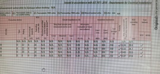

On the final real page of the EICR there should be a 'schedule of test results'.
One of the lines should be for the shower circuit, and Zs will be one of the columns with a figure, likely between 0 and 1 (0.45 as an example).
If you can post that schedule page, with no company or identifying information visible, we can tell you whether it looks sensible.
Given that there does appear to be moisture inside the shower, I don't think it would be unreasonable to ask for it to be tested again if you want to be sure.
It does appear that the shower needs fixing one way or another, if it hasn't been already, as any leaking shower can lead to a potentially very dangerous situation if the water ends up where it shouldn't.
It's not a 'electric shower' in the normally accepted definition. This is simply a shower mixing valve with a built in pressure boosting pump, and only consumes a fraction of the electrical power that a 'normal' electric shower would, so may not even have a dedicated circuit from the consumer unit.
The marks on the cover are inline with the motor brushes, so I agree that most of the black is carbon dust from the motor brushes.
That said, there should be no water inside the casing, so if there is, it needs immediate attention, and the shower should not be used in the meantime.

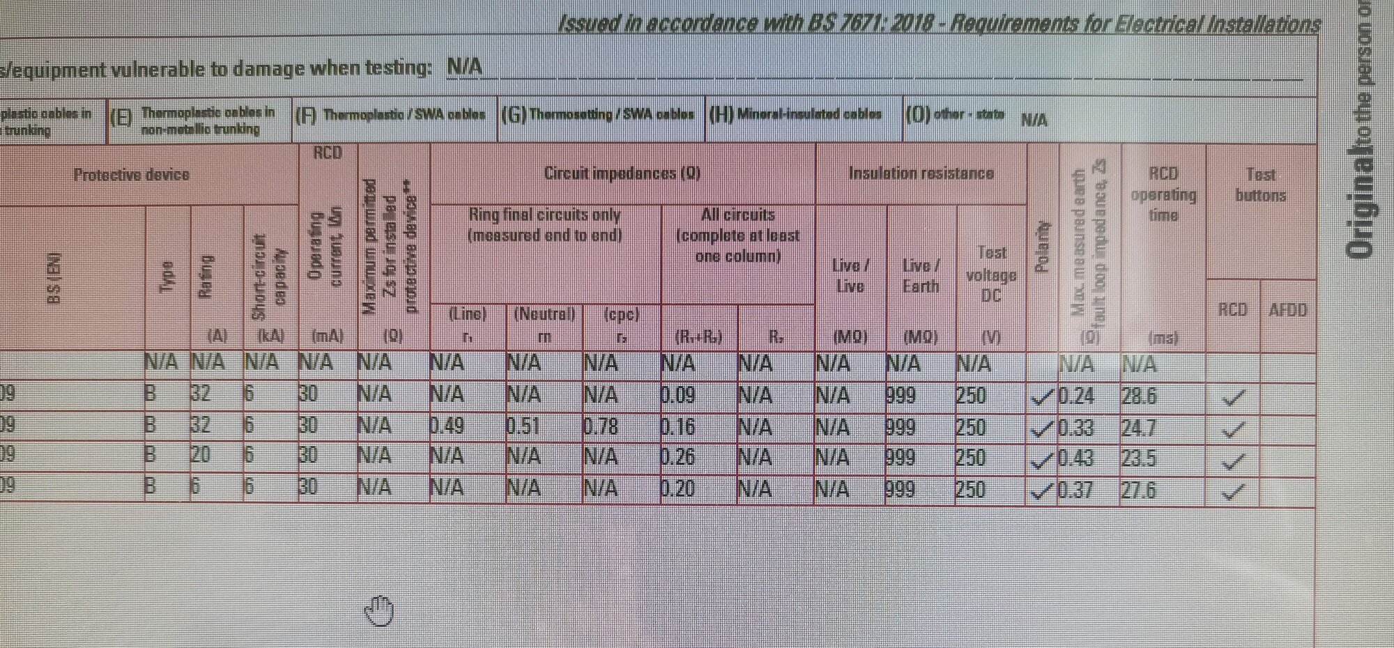

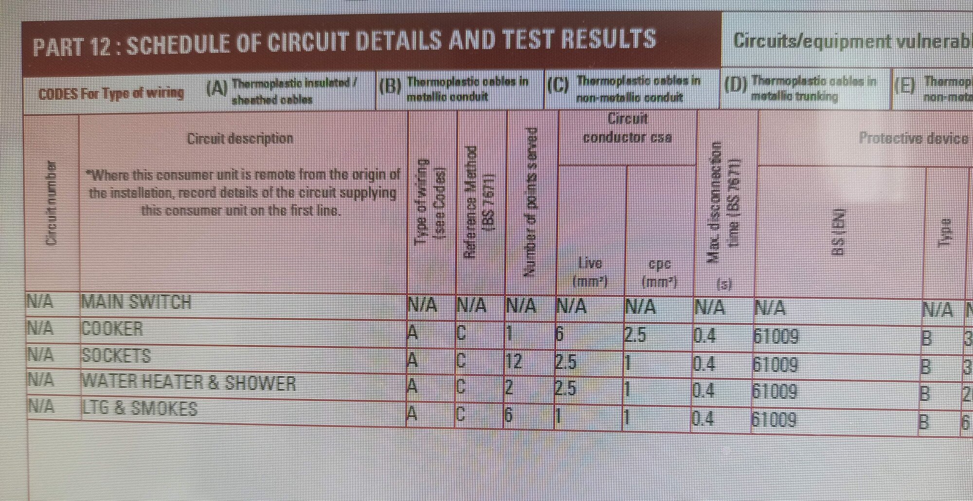

Hi Dartlec,
A recent EICR document was indeed requested after this mess, and issued before the end of the year (in 2021). I've taken a photo (2 in fact) of the section you've mentioned it on screen and I hope it's well readable.
2021 EICR: From what I see the shower description corresponds to the 4th row of the certificate and the column you mentioned would be the second column in section F.
All circuits maximum Zs are marked as N/A.
There are NO observations/limitations in this certificate.

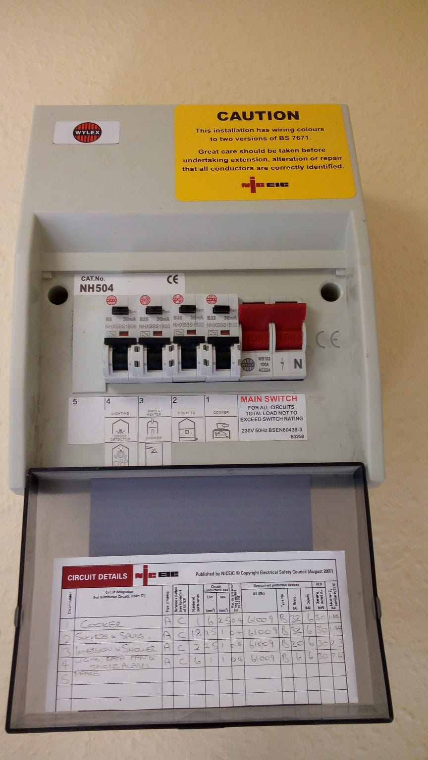

Thank you Brian,
Indeed there was plenty of water and I still don't know why the consumer unit did not trip.
I just cannot imagine why with so much water within the unit the shower power (sorry if I called it electric) just carried on producing those sounds, and leaking both internally and externally, without its circuit being cut off.
My guess is that if you have a RCBO in place then it should work, and that if it doesn't then the reason why it did not work has to be invested properly for a place to be considered safe.
There is indeed a dedicated circuit for it (circuit 3) in the consumer unit.
The rcbo can be tested to see if it functioning properly.
the shower... just carried on producing those sounds,
Could possible be "arcing".
For an rcbo to operate as a result of water ,then
L , N and E will usually need to be "sitting" in water and be physically very close to each other.

And I cannot find that value in the 2019 EICR or even the right section for it, unfortunately.
Many thanks,
Lonni
Limitations are decided by the inspector for their inspection so will vary between inspections depending on what they consider appropriate. They don't themselves require work to remedy.
To be honest the ones from the first EICR are clearly a generic list as many don't apply - and probably overkill. The second one should have had some - as no inspector will pull walls apart or lift floorboards to check where cables are running. However, it's not a particularly worrisome issue imo.
The N/A for maximum Zs appears to be an form filling error, but the tested Zs is there as 0.43, which seems reasonable, as does the RCD trip test.
The issues with C3 for the consumer unit are related to the fact that it's plastic and that post 2018 new boards had be be metal. However, there was never a requirement to replace old boards as long as they were correctly installed.
Some people would put those down as a C3 because it encourages them to be changed (though a C3 means recommended but NOT required). However, the general guidance is that as long as there are no loose connections and the consumer unit is not directly in an escape route, then no coding is required.
I am not sure on the bonding clamp one, but it may be that the tag that says "safety earth connection, do not remove" wasn't clear, or perhaps the second person was able to tighten a loose connection and therefore didn't consider it worth mentioning.
Generally in matters of judgement, there can be fine lines between a C3 and no code at all - rather in the way that MOT inspectors will vary somewhat, even within fairly clear guidelines.
A C3 code really only means that an improvement can be made, but is quite a lower standard than a C2 code, which means that a dangerous fault could develop if remedial work is not completed.
It's not unusual for an EICR to have many C3s and still be entirely satisfactory for continued usage. However, a single C2 will make the entire installation unsatisfactory.
Although seeing a shower like you had is clearly worrying and some of your concerns are valid - the shower itself clearly needed/needs to be corrected so there is no water leakage, the electrical inspections themselves seem at first glance to show a safe installation.
I hadn't picked up that it is not a full 'electric' shower in common usage of the term but rather one with a powered pump, though of course with still plenty enough current to cause safety concerns should things be dangerous.
In this case though it is entirely possible that although the cables were moist, there was not actually enough connection between them to trip the RCD - that doesn't mean the installation is dangerous, just that water is not as great a conductor as some people think (it's the contaminants in water that generally make it more conductive). 30mA is specified as the safety cut off because it is considered low enough to protect against serious shocks for most people and it really does not take much to trip one in a fault.
If the leak in the shower has been fixed, then from what I've seen I would not really have any other concerns with the electrical installation in terms of safety - and it certainly seems compliant with the current requirements in terms of protection against electric shock.
