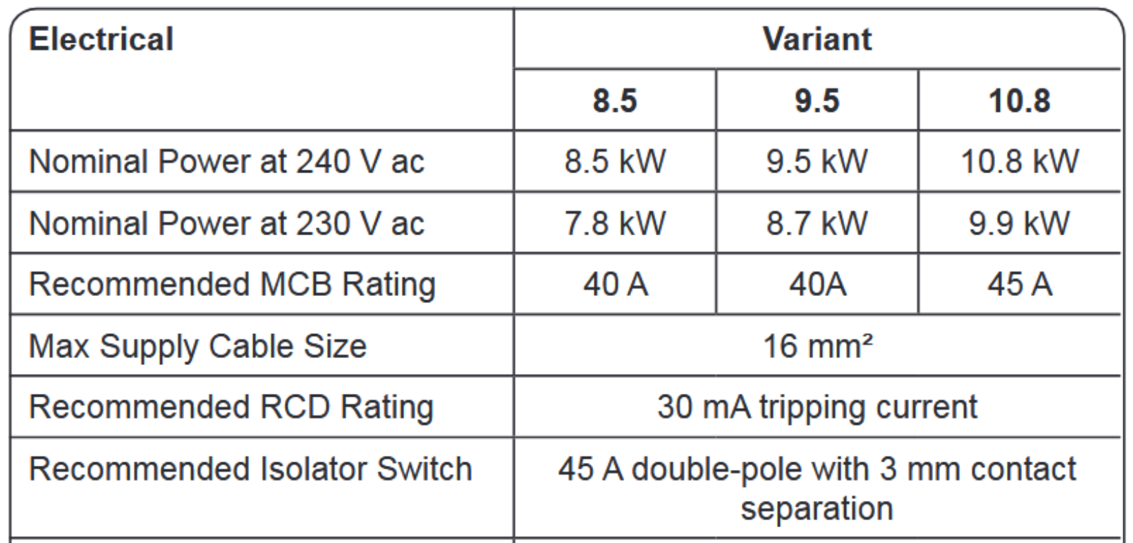

Thank you for your prompt, and detailed response. I guess my concern now is whether the 45 amp RCBO, protecting just the shower, will give rise to spurious tripping while using the shower🤨
Hopefully this will put your mind at ease... this may not be the exact model, but this is a capture of a portion of a Mira shower installation guide.
