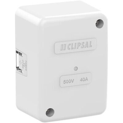

Yes they make such a thing-
This is a standard j box as used by the Australian electricians.
If you are wanting a box to use to encase an existing wiring junction without having to undo the wires, then this is the thing.
you simply put the base plate behind the wires,
then you cut horseshoe shaped holes in the appropriate sides
to suit the wiring pattern
Then the cover goes over that and is screwed into place
