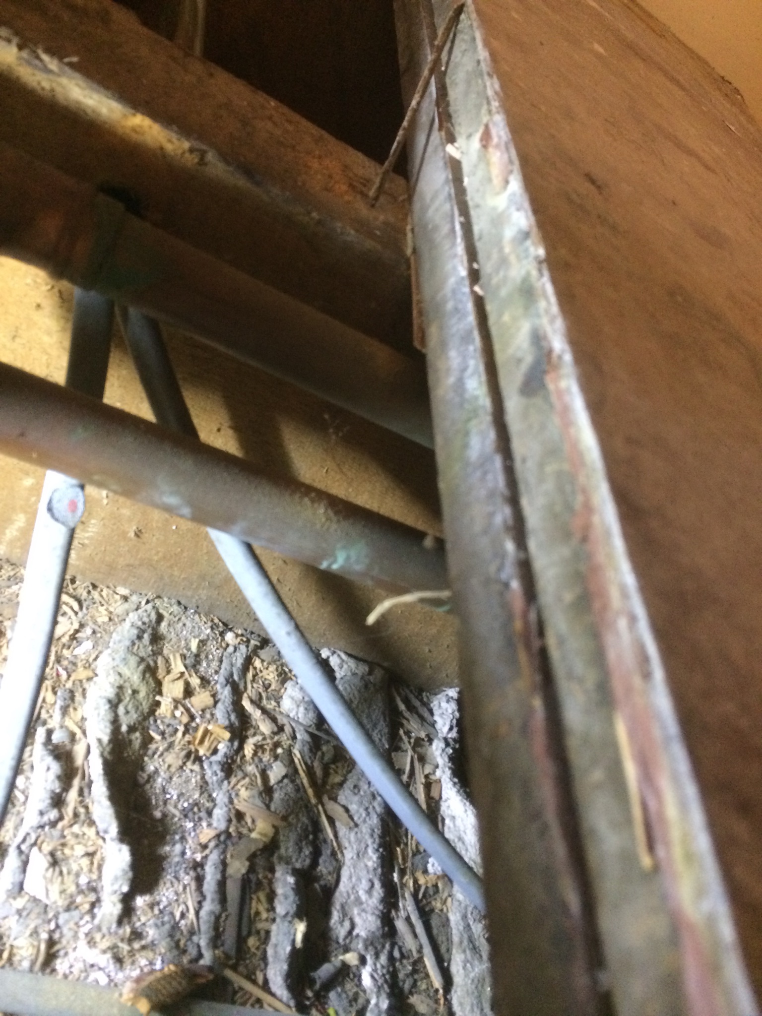

Recently had an extension done. Noticed electrician had run mains electrical cables right on to the hot feed from the boiler which gets very hot. Is this a safety issue? Can the insulation stand the heat for hours on end?..
Found similar in my own house...
Sacked electrician, I had to lift a floorboard...cable wrapped round the copper pipe feeding first radiator from the boiler...managed to slide some split insulation over the pipe, separating it from the cable...
believe me, this was a deliberate act of sabotage!
Hours on end will be fine, it's not an immediate safety issue. Most cables are rated to 60 degrees celsius and most domestic hot water systems barely reach this temperature.
Over years or decades the cable insulation will be made brittle by the heat which will be a problem. As mentioned above a short length of insulation on the hot pipe where the cables cross it would be advisable.

True, Marvo...but trust me, that copper pipe was already frying the cable...it's a high-output combi and the pipes are far too hot to touch without burning yourself...
No, he intended a failure, and by pure chance the equally crappy joiner had left a floorboard proud, so I lifted it to sort it and that's when i saw his "artistry"...
This wasn't a casual close cable, this was a cable deliberately wrapped spirally round the heating pipe 3 times...
I've come across PVC cables in contact with steam pipes (115 Celsius) in the past and whilst the insulation had become very brown in colour and completely brittle and crispy over a year or two it hadn't failed or caused an electrical fault. I'd consider it similar to old VIR wiring where the insulation physically degrades but it wouldn't usually cause a fault unless it's disturbed. I don't think it would be an effective way to cause a deliberate fault.

Most PVC cables are designed to operate at a constant 70c.
However most heating systems are set for 75c.
Very bad practice to run together. Sparky needs to come back and rectify. Separation of services and mutual detrimental effect spring to mind.

and in response to Pirate, I'm sure a man of your calibre can make safe, cut the cable, unwind from the pipe and reconnect in a suitably placed MF jointbox.

Yes littlespark, I can do that fix...if I remove the flooring under the staircase, the carpet and underfelt and the ply over the original floorboards!
Basically, I was making good the loose floorboard when I saw the problem, but the wound-round cable was 6 feet away under a new staircase, it was 11pm and the carpetfitters were due at 8am the following morning, so Mrs Pirate vetoed the disruption, so I slid lengths of pipe insulation along the affected pipe with a stick...luckily there was just enough slack in the cable for the insulation to slide under it.
Not too pleased with the wetpants either as that pipe should have been insulated anyway.
