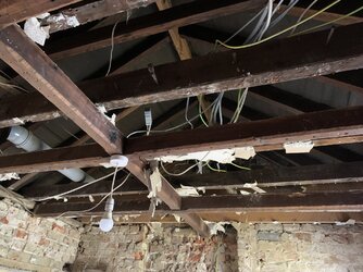

I'm renovating a property and vaulting a kitchen ceiling to gain more head height. The floor will be a slab which is yet to be laid.
Would it be better to run the cables for sockets down from the top of the wall where it meets the pitch of the ceiling or up from the floor slab (from within conduit within the slab) to be compliant with electrical safe zones? The consumer unit is in this room so either is easy in terms of access.
Just keeping in mind the 150mm you are allowed at the top of the wall but not sure if this is relevant if the ceiling is vaulted?
Based on nothing whatsoever, I would say that the zone is still valid.
There is often a triangular hollow space between the top of the wall and the ceiling timbers in this kind of construction, which I have used for the horizontal cable runs.

Unfortunately no such luck. I was going to run the cables along the wall plate covered with plastic capping. Plastering will be 3 coat Lime.
The usual way of finishing this would be to insulate and board the roof timbers, then board up the wall, usually over insulation, until it meets the roof boards. This leaves the triangular space on top of the original wall that I referred to.
ah right. thanks that makes sense. Not sure what I am doing with the wall so far. It's a listed building so very much up to the conservation officer. Suspect it will be wood fibre insulation between and below rafters and 3 layer Lime plaster on the wall. Won't leave much of a triangle that way.
The lime plaster will be 25mm deep so thinking that cables in capping should be covered ok shouldn't it?
