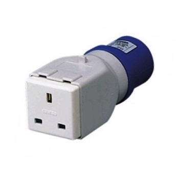

Thanks Sean, I've not seen that particular tester before.. Presumably if I make up a round three pin plug to normal 13amp socket adaptor/test cable, in the event of any problems in the caravan, I could then test direct on the site outlet to get an indication where the issue was...
You could just buy the adaptor unless you have the parts lying around.
A plug in style tester is about the best thing an amateur can do !

That would come next and it would depend where the issue was thought to be as to who's responsibility it would be to do that...
