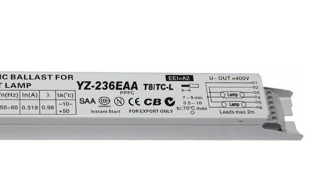

I replaced them with a pair of (high end) fluorescent lamp fittings, 2 x PL-L 4 pin 36w tubes in each fitting.
Each fitting has an instant start electronic ballast powering the 2 tubes.
After 1 year (to the exact day!) one of the fittings flickered a few times and the 2 lamps went out and would not switch back on. Took the cover off, felt the ballast which was hot but not beyond the 70c operating temp.
The unit was exchanged under warranty.
Fitted the replacement unit and after around 30 mins of use the lamps went out (new bulbs), and would not switch back on. Replaced the bulbs (correct spec), but still would'nt work.
Now Realising the ballasts were failing I replaced the ballast and re-fitted. But again, 30 mins after use the lamps went out, this time both brand new Philips tubes were completely blackened at the ends.
So, ahead of calling in an electrician and to give him/her something to work from, I fitted new tubes and another new ballast (all correct spec etc) and put the fitting back up. Unfortunately the missus forgot and switched the light on, but this time the ballast had blown within 5 minutes and again both tubes were blackened at the ends.
The unit in question is the 2nd and final fitting in the loop, the first fitting from the same supply and using the same lamps/ballast etc works fine and continues to do so.
Polarity is correct, the ballast is earthed correctly, I have no other issues with power surges etc that I know of and all visible and accessible wiring connections are good. I've not checked actual voltage at the supply as this was something I'll let the electrician do. Haven't had any issues with blown fuses etc.
If I replace the suspect fitting with a normal 100w tungsten bulb it works and operates fine.
So my question is, what could cause an electronic ballast to blow so often and so quickly, particularly when an identical fitting just 6' away works and operates fine?

I've just compared the 2 fittings, and they are definitely internally wired up slightly differently but at this stage I don't think it is the cause of the problem.
Outlets 1 & 2 of the ballast both go to the same "side" of the 4 pin tombstone but on one of the fittings they are swapped around, i.e, on 1 fitting wire 1 goes to pin 1 and wire 2 to pin 2, but on the other fitting wire 1 to pin 2 and wire 2 to pin 1.
Wiring diagram is on the image, from what I can make out, it doesn't matter which way around wires 1 and 2 go as long as they are both connected to the same "side" of the 4 pin tombstone, but please correct me if I'm wrong.
You to ensure that the wires are connected exactly as on the unit that is working.

The electrician came round tonight...not long left.
First thing he did was install new ballast in the fitting. It's a higher quality Philips warm start ballast as opposed to the Chinese instant start ballast previously fitted so he had to rewire a couple of the terminals.
Plugged it into the wall and left it for an hour or so whilst fiddling with other stuff, and it worked fine.
So, I've asked what's causing these ballasts to keep blowing after 30 mins usage?
He checked the connections at the open rose, L+N = 250v and L+E = 250v.
He said that could be the problem, electronic ballasts can have fairly low voltage tolerance, and the excess voltage could be the problem, or, his meter might be over reading.
He checked a wall socket to compare, also 250v.
I asked him to run his meter over a car battery I had sitting around, it read 13v. (Should be 12.6v).
So, I pulled out my own multimeter (it's donkeys old from when I was an auto-electrician). Ran that across the battery and got 12.59v, probably accurate.
So he ran my multimeter at the rose and got 246v and again 246v at the wall socket.
Now he's thinking 6v excess is probably not enough to cause these ballasts to keep blowing, especially as I've got an identical light on the same kitchen circuit that's working fine.
So he suggested I pull the other light down (the 1st one in the ring of the 2 lights) and check all connections within the loop are tight and do the same at the wall switch. He advised that a loose connection somewhere could potentially be causing an extra current draw causing these ballasts to fail.
If all connections are sound, then he has no idea why the ballasts keep blowing, only to conclude they are of poor quality. The light itself is a fairly high end unit from Endon lighting, retailing well over £200 in shops. Endon lighting themselves advised me they'd never previously had a warranty claim on this light model relating to failed ballasts.

May have finally found the cause of all these blown ballasts...not 100% sure, but appears likely.
As advised by electrician I removed all switch plates and other downstairs ceiling roses in search of a loose connection.
No loose connections found, but in the first ballasted light of the circuit I noticed 2 blacks looped together with brown sleeve going to the live terminal of that fitting. Only 1 black neutral going into the neutral terminal.
Got me thinking, where the hell is the neutral coming from for the final light in the circuit (the one that keeps blowing ballast).
Continuity test showed polarity in the first fitting was wrong and the 2 "lives" were in fact neutrals, despite the brown sleeving.
The "neutral" was the switched live.
I corrected the polarity and have had both lights on for an hour or so and all seems fine thus far (although early days).
Therefore my amateur conclusion is that for years using GU10's and Bayonet 100w bulbs the polarity wasn't a major issue, But with incorrect polarity, the first ballasted light in the circuit worked fine, but was sending an excess voltage to the 2nd and final light causing it's ballasts to blow. (No idea why the orignal ballast lasted a year though).
