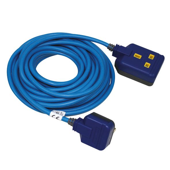

Pub kitchen I was doing PAT for, opening at 12 today. They have had to reconfigure where everything sits, so new location for double deep fat fryer is too far away from sockets.
Double fryer is basically 2 x 3kW fryers in one unit… two leads, two plugs.
I’ve told him not to plug both onto same double socket which is nearby… partly 24 amps going through one point, and partly I know the double socket is a spur, and one socket on it is powering the extraction fan.
So, just for this weekend, a suitable extension lead is needed to run one half of the fryer.
No one nearby stocks plugs and sockets to make up my own, so I saw this. Will probably shorten it, 3m at most needed.
Do you think this will last long with a 3kW load on the end?
https://www.NoLinkingToThis/p/masterplug-13a-1-gang-unswitched-extension-lead-10m/44635
At short notice it is probably your best bet and should last long enough to get something more permanent sorted.
I guess only other thought is to make sure the plugs are clean and maybe inserted/removed a couple of times before use to clear any tarnishing, etc. Same for lead in to wall socket.

It is technically rated at 3.1kW, but in my view kit like this never really stands up to its supposed rating for too long.
Should last until you get a proper radial for 6kW though.
There was an unused 32A radial that was marked cooker, but had a double socket on it. I’ve already extended it to supply his 25A dishwasher. Would have been perfect.
