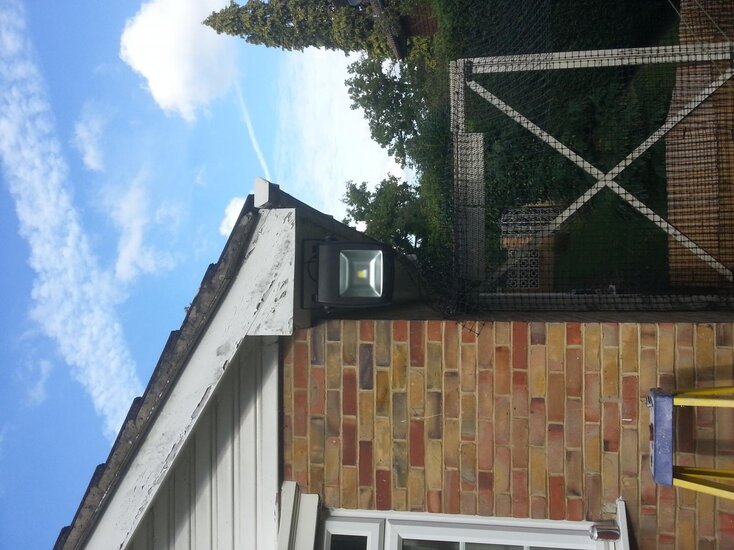

I recently fitted two Flex 50w LED flood lights on a bungalow so the client could see his cats in the garden. He didnt even blink at the cost of the units, each one was £110 +vat! Plus they looked pretty ugly on the property but he said he liked them. I want LED floods on my house but will wait for costs to come down first!
