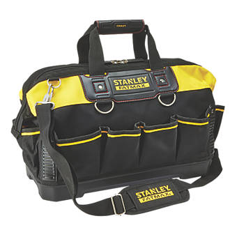

I have a stanley toolbag like this. It is about 1 year old now and it has had a lot of use. The handles are starting to wear but it's still going strong.
I would recommend this bag for starters as it has loads of pockets which makes it easy to organise screwdrivers, pliers etc... Let me tell you there is nothing more time wasting than fishing around in the bottom of a toolbox/bag looking for your smallest screwdriver. and also it doesnt do some tools any good battling with club hammers and pry bars :)

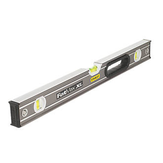

I have another toolbox with basic hand tools in it - some cheap wood chisels that can take some abuse, club hammer, pry bar, uninsulated screwdrivers, cold chisels, etc. and you want two levels - a boat level for levelling sockets etc and a 600m one for leveling bigger items like 3ph db's and metal trunking. i have the stanley fatmax range
