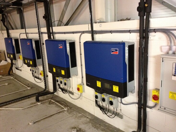

You'll end up with something like this:
European installation standards for US based installer 1-IMG_1230.JPG - EletriciansForums.net
That's very useful for me to to see. We don't get to use flexible cables and plastic trunking, so a lot of our installation time is on bending conduit, fabricating gutter, etc. I'm jealous.
