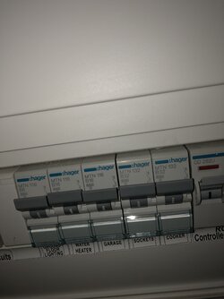

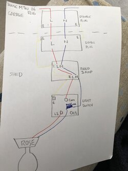

Hello, would appreciate a steer please for extending power further into the garden. Fuse box has a dedicated fuse (see pic) for Garden providing 16amp. Had an electrician that has previously connected armoured cable from existing double socket in garage into new shed providing a double socket, with a 3amp fused spur providing a light (see pic). Now want to extend further to provide 2 further double waterproof sockets - one for small summer house and other near arbour for music.
Not sure whether I can spur off shed double plug or have to wire in something different to provide desired outcome, thank you in advance.

It’s a radial circuit on a 16A. You can branch off anywhere.

You can get light switches that have a N terminal, so no need for a bullet connector
Thanks really helpful. It will be a quality job, OCD helps ;-) and certified for sure. So as radial circuit a fused spur for the 2 further double sockets? Thanks again

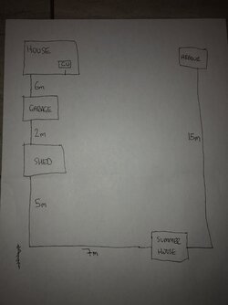

Any chance of a block drawing showing house, shed, summer house and arbour positions, relative to each other.
Cable distance may also be an issue, so distances from each other would also be good.
Do you know size of existing cables? House to garage. Garage to shed.

Thanks Spoon. Pic attached of building layout and approx measurements. Cable for the complete run into garage and to shed and will use the same for summer house and arbour is SWA Cable 3 Core 2.5mm.
