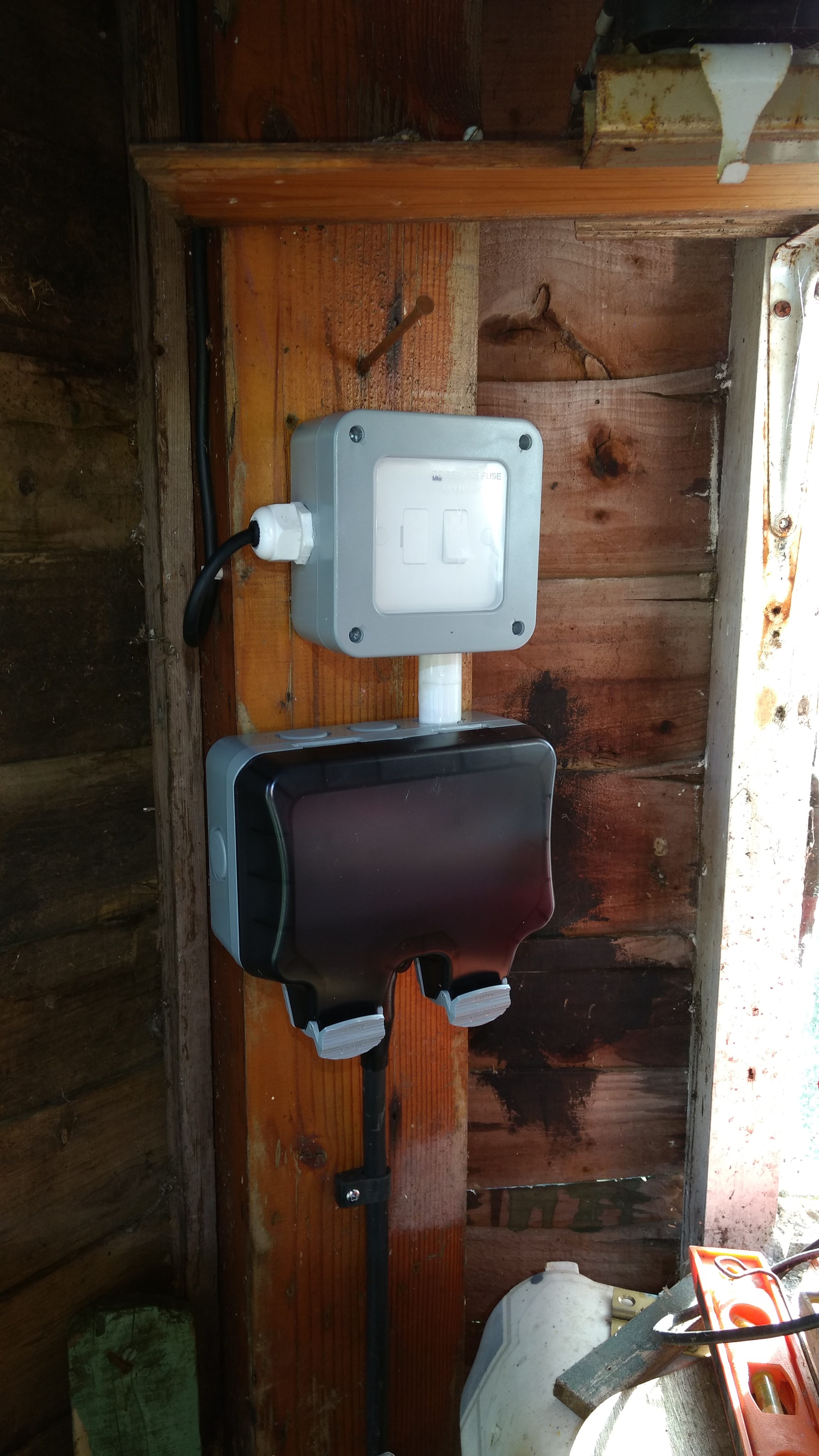

Got a job coming up need to install a fcu coming of a RFC in an adjoining office room to power a light circuit. the light circuit will be in a large greenhouse with lots of water being sprayed for the plants and flowers so need suitable IP rating, albeit the FCU will be out of direct contact with water, just covering all bases so using IP66
Looking at BG 13 FCU w/ Neon - https://www.screwflix..com/p/bg-13-fcu-w-neon/27437
Anybody used these? and had any issues getting a 1.5mm 3 core swa with gland in and terminating properly?
Cheers @SparkyChick I expect it will be fine for a small swa gland, you got what looks like a 20mm nylon one in there without too much difficulty and the sizings are alike for the switch enclosure.
I got a couple of methods to get the job done, just planning it out before hand.
Stuffing glands are not meant for cord restraint, I guarantee I could pull that out.
with sparkychick's wicked feminine wiles, she's probably used gorilla glue. in any case that's not the issue. that gland should have been grey or black, not white. :D:D:D.
True.
Hi - I have done this (but not sure it was BG) and there's 2 things from memory ... the usual swa gland with plastics (use 2 nuts and banjo or piranha) ... and it is all a bit of a close fit but should work (mock up first?).
I will do a mock up before wall mounting and messing around with knockouts etc... worse case will be I will use a IP66 box next to the FCU and run a small bit of flexicon between them, I shall terminate the swa into this and run the cores minus armour through conduit to the FCU. It will deal with the space in the enclosure as i know they can be a bit tight with the swa glands. Havent used the BG ip66 FCU before as my usual supplier no longer has any of the ones i would usually use.
Regarding the lining up of the edged... I concur they don't line up, however, it's a choice between cut a hole or use the ones provided... and guess what.... none of the ones provided would have allowed for it to line up.
With regards to restraint... I can't recall whether I put a cable tie on the inside. But regardless, I need to learn something today, so what should you use for that situation?

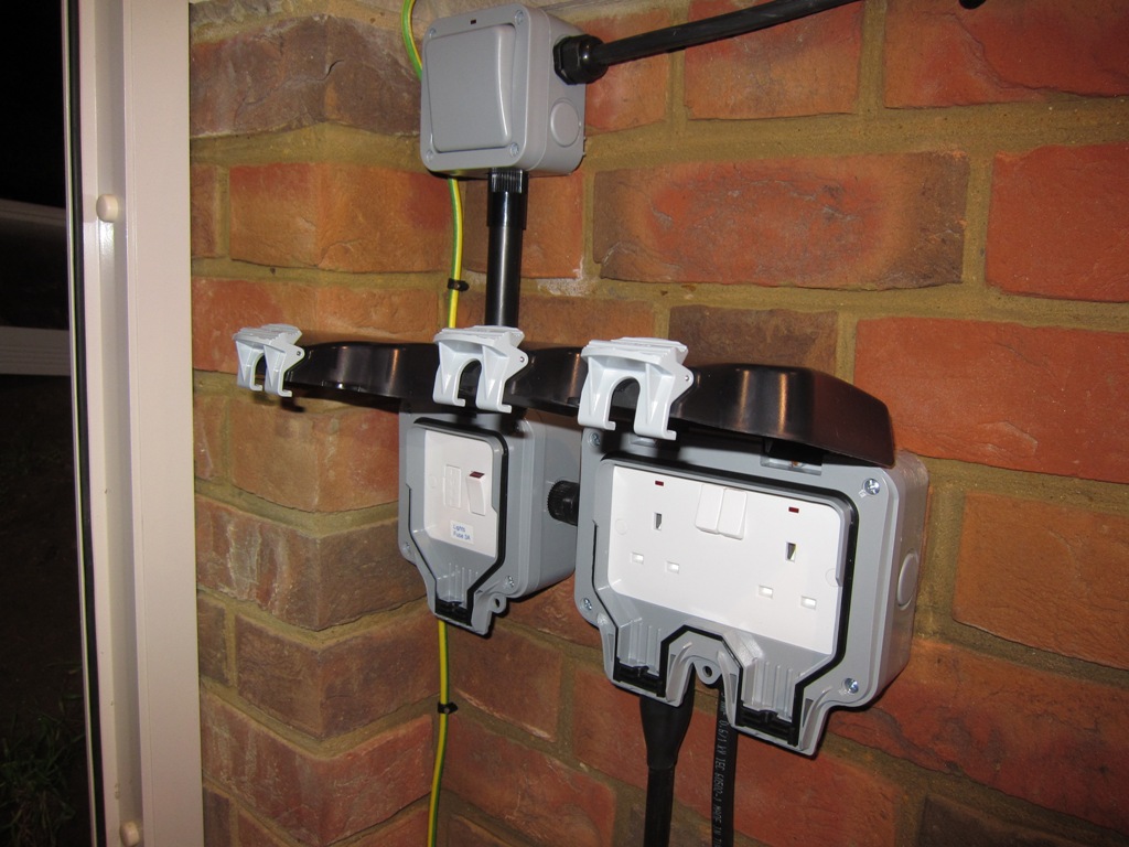

I generally like the BG outdoor stuff, but the FCU is awful. I used one once, but the flexible membrane eventually goes sticky and opaque. Plus, you can't replace the fuse without taking the whole thing apart.
I now take one of their single sockets and replace the socket plate with a FCU one.
I know with the BG stuff the bodies are largely the same but you can swap accessories around if you want.

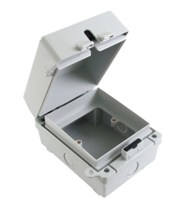

I have actually just seen on the Denmans website when ordering some other stuff for next week that they stock the empty outdoor accessory box which you can put a fcu, socket, switch etc in. doesnt have the membrane front either. i will have a look when in on Monday. only £7.48 + vat
